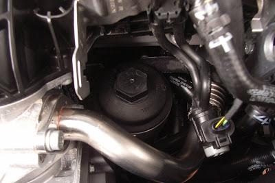

    OK sorry if this is a stupid question. I have done quite alot of mechanical work in the past, so am no noob. I dedided to do an oil change on our TDI yesterday. Bought the oil (Penrite) and filter from VW. The stupid question is where is the filter located? There is a plastic (filter) housing at the left rear of the engine under the turbo piping. It has a large nut on top. Is this it?

    Tiguan Oil Change 103kW TDI engine
    Parts needed
    Remove top engine cover (pull up wards in each corner)
    4.0L Engine Oil............................................... .........................VW507.00 Castrol 5W30 PowerFlow Professional Formula, Penrite Enviro+5W30, Shell Helix UltraExtra
    Oil filter cartridge .................................................. .................VW P/N 071 115 562 C (Purflux L267A) (Mann HU719/7) (Mahle OX 188 D)
    Drain plug with washer
    Tools needed
    32mm socket
    ratchet
    long extension with universal joint
    17mm socket or ring spanner
    Torx bits set for removing engine splash guard
    Oil drain pan for used oil. Care for the environment; clean all the spills and dispose used oil properly!
    Instructions
    Remove engine splash guard.
    Remove drain plug to drain oil
    Remove component above the oil filter housing to gain better access
    Unscrew and remove oil filter cap and remove oil filter from the filter housing
    Replace the oil filter
    The rest of the procedure is in reverse order.
    Oil filter location

      Thankyou, much appreciated. Why not do one of these for each engine type & make them a sticky?

        The 1.9 and 2.0l TDI are so similar that it wouldn't make a sense, at least not just for the oil change. Here is the fuel filter how to in the diesel section.

            It would be very similar only the oil filter is spin on type. Located at the same side of the engine only at the top, more to the left (driver side).
