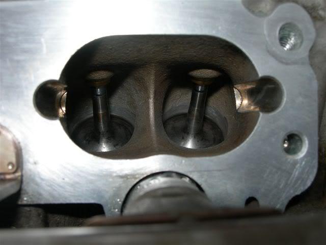

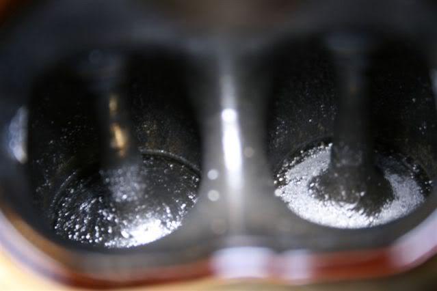

    pics of valves before and and after (only 1500k's on this engine!):
