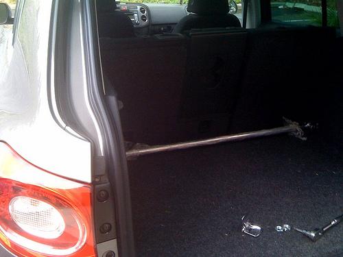

    Please excuse my ignorance here, but is there a difference between the "Sway bar" you speak of, and the "Stress Bar" that this guy has installed in his boot of his Tig? http://forums.vwvortex.com/zerothread?id=4618298
    If they are different could someone explain the pro's and cons of each option?

        Not sure WTF that is ..... a stress bar using OE mount points in the boot ?????
        I see no benefit in fitting that ...... what you need more than any other suspension components other than springs are front and rear strut braces .... then only do you do sway bars. Strut towers are much more likely to be moving under cornering stresses than anything else and stabilising them is more important than an upgraded sway bar IMO.

            Why anyone would put a rear strut brace in a Tig is beyond me.. nice way of losing more boot space (which is the same as a GTI boot anyway basically). Perhaps they got the wrong car.

              That "stress" bar actually takes up less useable space than what a rear strut brace would. And you're absolutely correct ... you would have to think seriously hard about why you would want to fit one. On a GTI it makes far more sense than on a Tig.

                      A stress bar (as shown in pics) is used to reduce body flex, by stiffening the tops of the suspension strut towers.

                        A stress bar ... who knows ... possibly will reduce body flex but I am not convinced. The 1 in these pictures are not attached to the tops of the suspension strut towers.

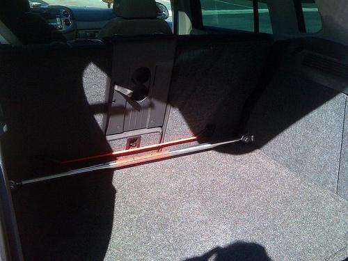

                          Check this out a picture showing with seats down and cargo:
                          The cargo space seems pretty usable?
