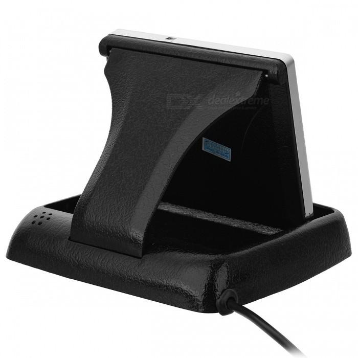

    Up front I got a 3.5" LCD screen which comes in a nice fold-down form factor. Cost a wallet busting US$52 which i thought was decent. I'm struggling with positioning it though. Initially I had it in the middle of the dash depression, but the wires going down to the 12V socket were unsightly. At the moment I have the wires running under the dash and up the right hand side near the door, and the screen is sitting on the right near the windscreen air vent. Still not ideal, but I'll work something out.

            Yeah, I looked at the Gator ones at DSE but was far from impressed with them. That's why I went the Deal Extreme route. Cheaper, less risk of throwing money away, and better than eBay coz there are no delivery charges.
            The screen I got folds away nicely so it isn't very obvious if that's a concern:
            I forgot to mention too, that the screen overlays grid type markings to help you judge distance up to 3m, but you cannot calibrate it at all so have to set your camera up properly to approximate what's shown on screen. Or just do what I do and ignore it

                Thanks Arctra. Good point about expense, it doesnt hurt as much when you throw away $50 instead of $300. I guess they all do the same job, you would normally pay for the name. All these gadgets are made in China these days and cost next to nothing to produce.
                I like the idea of the folding screen, it eliminates the visual issue.
