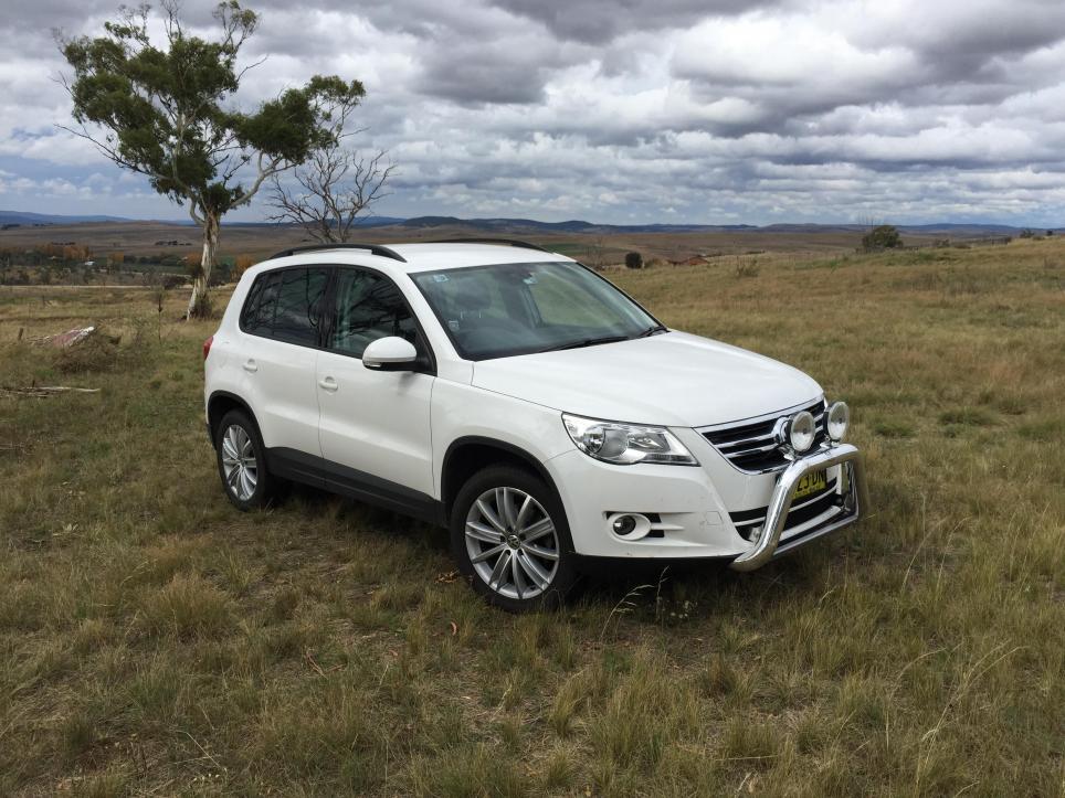

        On my 2010 Tiguan I have both aftermarket fog lights (courtesy of the previous owner) and Hella driving lights. The fog lights were originally on a seperate circuit with a button, but I had Euro Car Upgrades connect them properly (using the BCM, a new switch, and coded correctly) when they did a bunch of other work. They also fitted a new push bar and old driving lights I had from a previous car. The driving lights used the seperate circuit vacated by the fog lights, but are now connected to the high beam (as required by law).
        I have no idea where the previous owner got the fog lights from, but I'm just here to say it can be done, although it’s a bit of mucking around.
