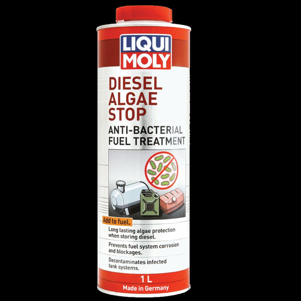

    For the algae issue, give this a shot for now..
