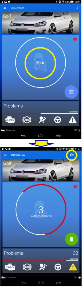

                      Hugo: hopefully your OBD11 device will arrive in time (sounds like a tight delivery time tho). When you get it and after you do your first scan - do this:
                      After you select the envelope symbol, you will be presented with the native email App(s) on your tablet/mobile phone. If you send yourself a email copy, you will have a digital version of the report that you can easily share on forums like this one!
                      Don
                      PS: You might want to consider removing the VIN if you do post-up a copy - gives greater anonymity and leaving the VIN doesn't add any value to the purpose for posting the scan
