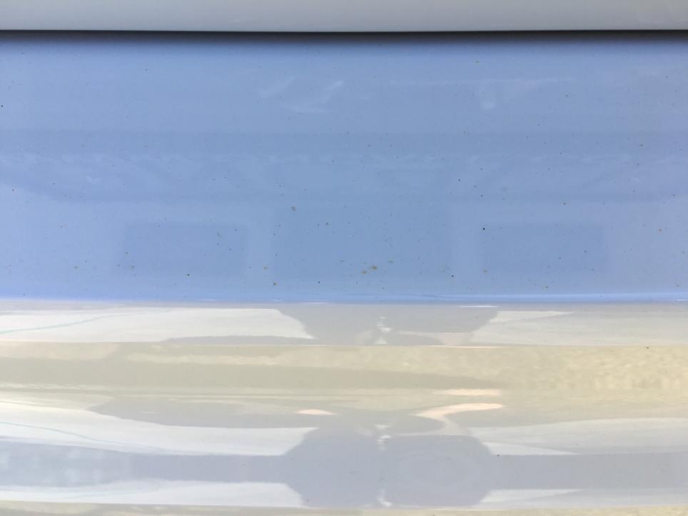

These LOOK like what happened to an old, don't laugh, Mitsubishi Magna I bought, brand new. Caused by filings that landed on the bumper bars from where the dealer drilled into the bodywork to fit the rego plates. Filings then caused surface rust on the bumpers' surface.Originally posted by NZ_GolfR View PostMy dealer did a great job or repairing the paint chips on the door of my Tiguan however unfortunately another issue has cropped up with my Tiguan.
After cleaning it for the first time over the weekend I noticed some yellow spots all over the front bumper. After looking closely I also noticed them on the rear bumper and to a lesser extent on the doors and guards. They almost look like rust spots but thought they might be tar marks (when you clean off the black tar it some times leaves some orange/yellow sticky marks that are a bit harder to remove). I tried some tar remover that got rid of a couple other marks but these didn't budge.
I had more of a look and noticed there weren't any sign of them on the bonnet, roof or tailgate which I know are covered in plastic when they ship them so this made me think it must be something that has got on it in transit. Emailed the dealer over the weekend and was a bit worried as I hadn't spotted it when I originally picked up the car about a month ago but the are really small and have to look closely to see but the closer you look the more you see.
Sorry not the easiest to take photos of.
Dealer got back to me first thing to say she got my message and was finding out with the service manager the best way to proceed. I dropped the car into them this morning and they are going to get a panel body shop to have a look at it and work out how to remove them.
Once again I am really happy with the way the dealer is handling this, they have given me a loan car to use while it gets sorted (surprisingly another Tiguan all be it a 2WD Comfortline) and at no stage indicated that there would be any issue with not noticing it straight away. Now I am just waiting to hear from them as to what they find out and how to get it resolved.
Sent from my iPhone using TapatalkWHITE 118FSI DSG MY12 Sports Pack with RNS510 Sat Nav - PICKUP Oct 17, 2011. Added Chrome bootlid spear-very nice, Golf doorsill protectors-not so nice and Aluminium Pedal set-EXTREMELY nice!
