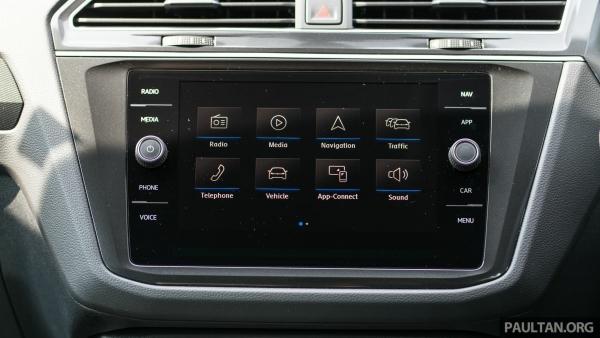

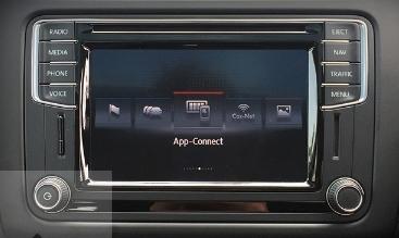

                  • In my Tiguan 2017 i had the composition media. The menu looked like the first image and it was "in a line".
                    I coded it somehow so the menu structure looked like the second picture, like a "grid".
                    I want to do it on my passat now, but I can't remember how i did.
                    I didn't change the headunit, it was only coded/adapted with vcds.
                    Does somebody know how I can do it?
                    Skickat från min SM-G975F via Tapatalk
