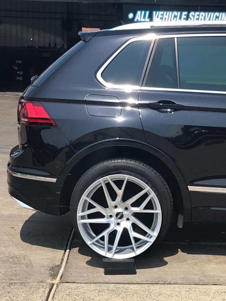

Specs on wheels? They look a bit like Brixton PF8’sOriginally posted by REXman View PostThese could be happening.
You want 255/40R20Originally posted by REXman View Post20inch 9.. rubber per convos, 255 45 20
