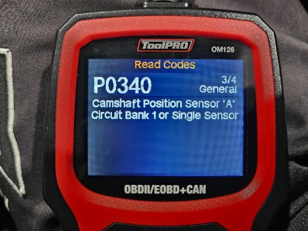

    However, we encountered a few new errors. P0340 Camshaft Position Sensor "A" Circuit surfaced, and after a few more hours of investigation, we found a forgotten connector. Issue resolved—great!

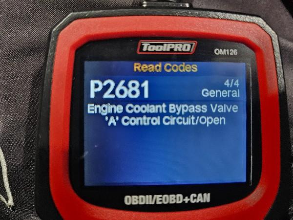

    Now, a week or so later and the car still not being used, I'm desperately trying to diagnose P2681 Engine Coolant Bypass Valve Control Circuit/Open. If i clear the code, It doesn't disappear - However it does remove engine light which wont come back until the car is locked and restarted.
    This one has me stumped, and I can't find much information online.
    Any help would be appreciated!
    That might be the N82 shut-off valve; I'm pretty sure the 1.8 is in the same location as the one pictured here Injection system engines 2,0 EA888 - Overview of fitting locations
    I would be checking if there is voltage at the valve connector
