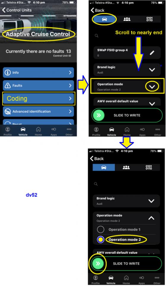

    Hi, I have an OBDEleven and have had some fun making a few changes but there are these two things I can not find anywehre and wonder if anyone has managed to come across them anywhere in the codes.
    First up is the increments when you're in Cruise and hit + and -. It jumps 10ks a hit. I would like to reduce that to 5ks a hit.
    Second is the low fuel nag screen. I am totally capaable of finding a servo when the fuel light comes on and the nag doesn't go away until you hit cancel. Anyone found where to just disable this stupid thing?

    Lee: This is how to change the increments on other MQB platform cars - should be t5he same on a 2nd generation Tiggy:->
    Note this changes the increment steps to +/- 1 km/hr and long-press +/- 10 km/hr.
