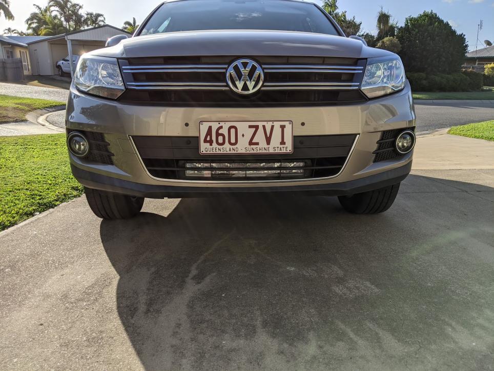

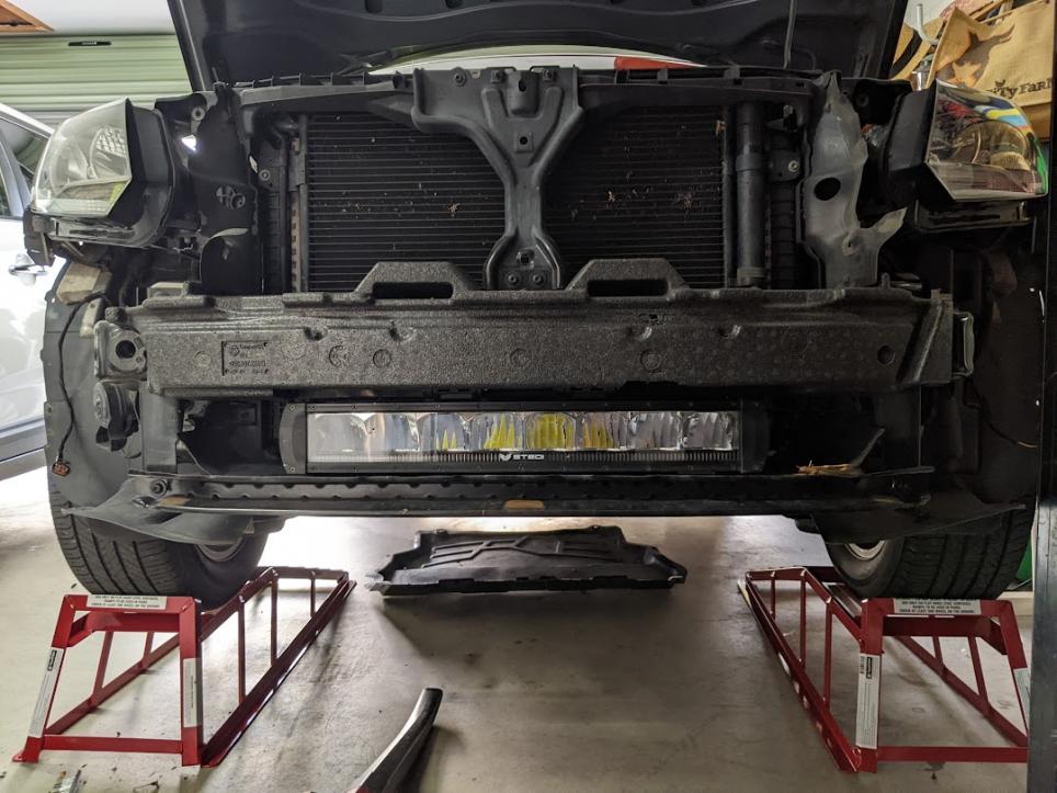

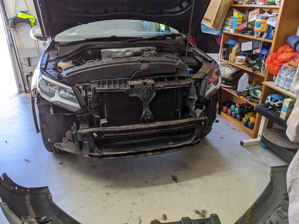

                        I have a 2015 Tiguan and I fitted a 32 inch Stedi curved light bar behind the bottom part of the lower grill.
                        It was "Professionally Fitted" using a Stedi number plate mount first up when I was working in Melbourne in early 2020.
                        When I moved back to Townville I refitted it to its current position.
                        The Front bar reinforcement is hardened steel which I could not drill thru with cobalt drills.
                        I got the four bolt holes water jet cut by a local sheet metal shop ( Cost $50 )
