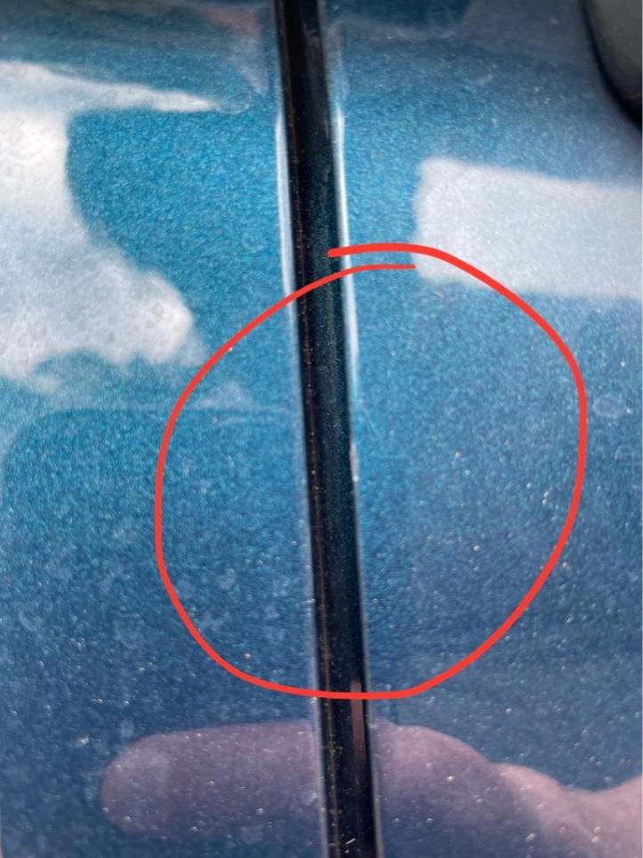

    I’ve just had my brand new Tiguan in with a VW dealer in Sydney to have a few small things checked out, and they managed to put a small scrape / chip in the leading edge of my driver’s door.
    Obviously I was pretty unimpressed, but I’m now looking at how to fix the chip. I’ll be asking the VW dealer to pay.
    I don’t want to simply brush-touch the chip, as that doesn’t usually look great. On the other hand, re-spraying the door is overkill.
    Can anyone recommend someone in Sydney who can do a seamless repair job - perhaps with spray and buffing? - and who will do a really great job? I’m hoping someone will be able to work magic and make the door look exactly as it did when the car was new (just a few months ago!).

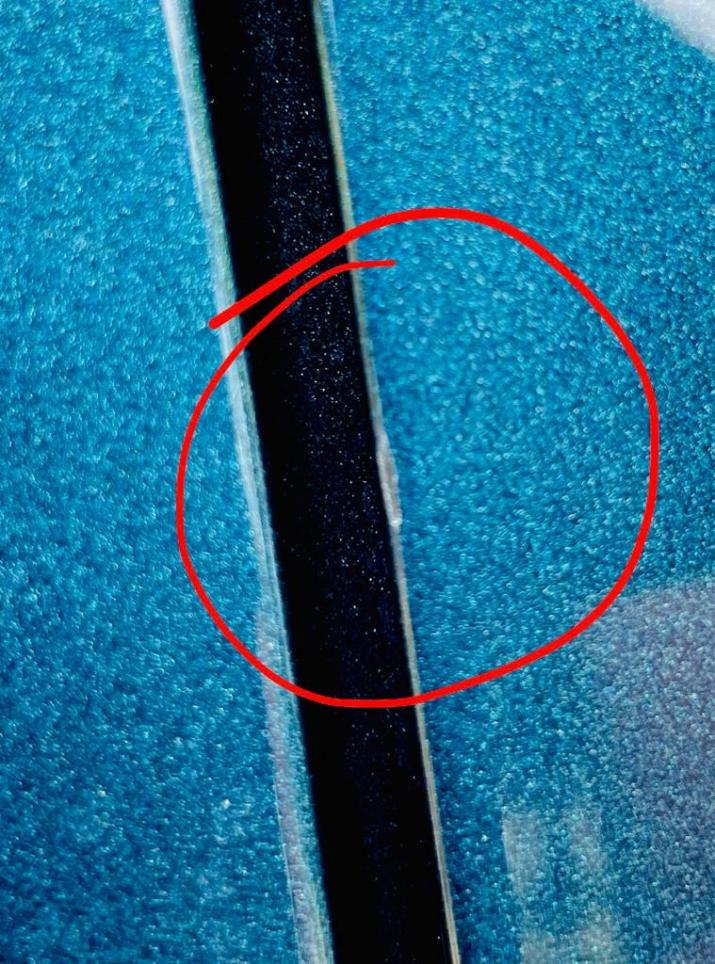

      Hey Hillbilly, yep - you’re right. Here are a few images.
        Touch it up and move on with life. That is not worth losing sleep over.

          A simple brush touch up paint will work on that with a follow up of wet sanding.
          If you are expecting a complete repaint or large scale job to complete that then you will be very disappointed.

            An artists fine brush and apply across it from inside out leave it for about 10 days to harden and use a fine cutter very gently on it.
