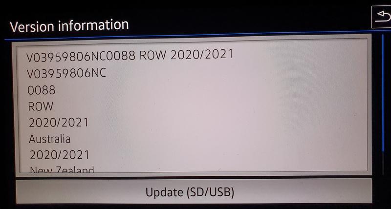

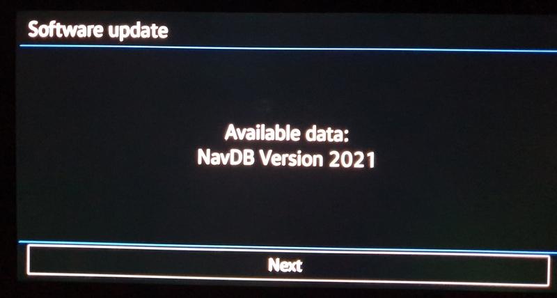

Follow prompts and tell it to do its thing about 3 hours later or maybe less it will be on your HDD.
This is presuming you have a Discover PRO or Discover Media in your car. Select correct model and year of vehicle first.
Put a 32gb SD card or a USB stick in the lappy Using 7zip or RAR tell it to extract the file you downloaded to the card Takes a fair while
7Zip is available from the map page if you scroll down to the bottom It says Zip software
I did it all the hard way in 3 hours yesterday and it works perfectly.
