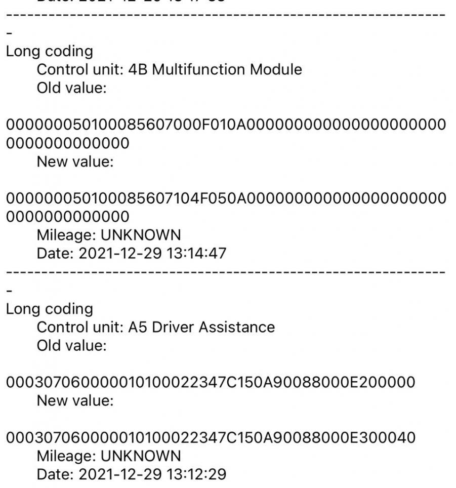

        Bought an OBDEleven, and completed these mods over the break on my 2018 162 RLine, best purchase ever!!!
        However I’ve somehow managed to program the fog lights to come on with the regular driving lights, any ideas on how to undo? [emoji1787]
        • #34
          Look in your history and reverse it

                    Hey, does anyone have instructions as to how to undo the steps for dynamic like Assist (DLA)? My fog lights seem to be on constantly now for some weird reason since I did this mod, I have checked 32 times to make sure all the steps are correct from the instructions in the opening post, just want to know what the values were prior to changing them to those settings if that makes sense.
                    • #40
                      You should have the history of what you did and so can reverse it
                      Mamba Ebike to replace Tiguan
                      • #41
                        Nice one thank you, took me about half an hour but figured out how to get the history email to myself, how do I know how to change this “new value” back to the “old value” as pictured below?
