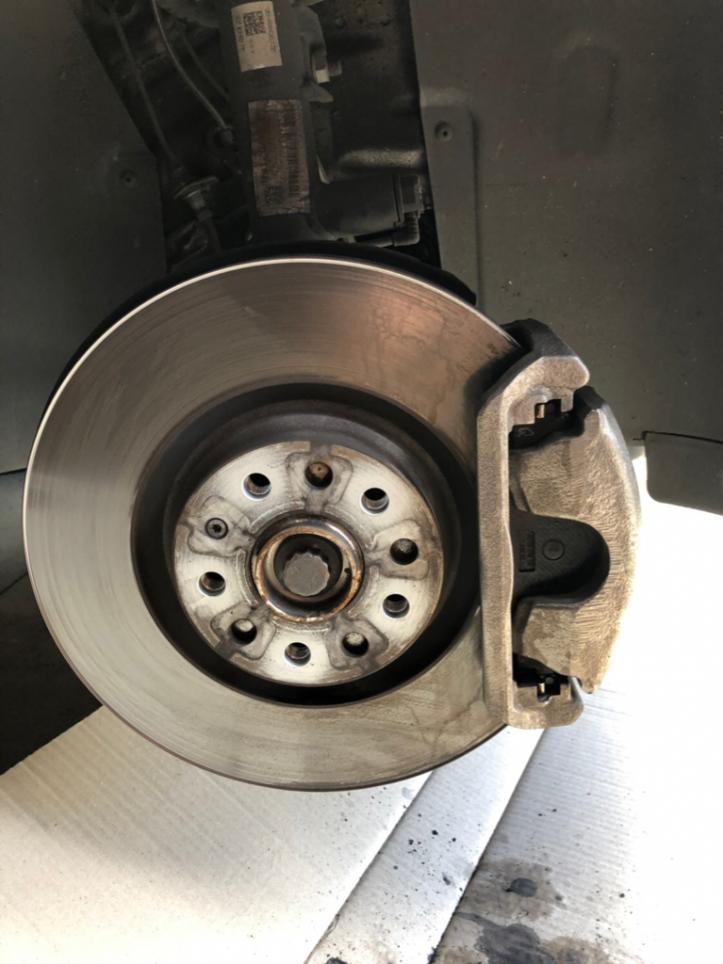

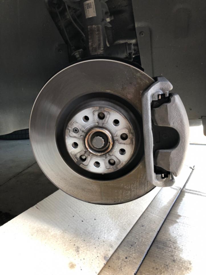

I forgot to take a photo of them before I started the job but this is what they looked like after giving them a good clean with brake cleaner:

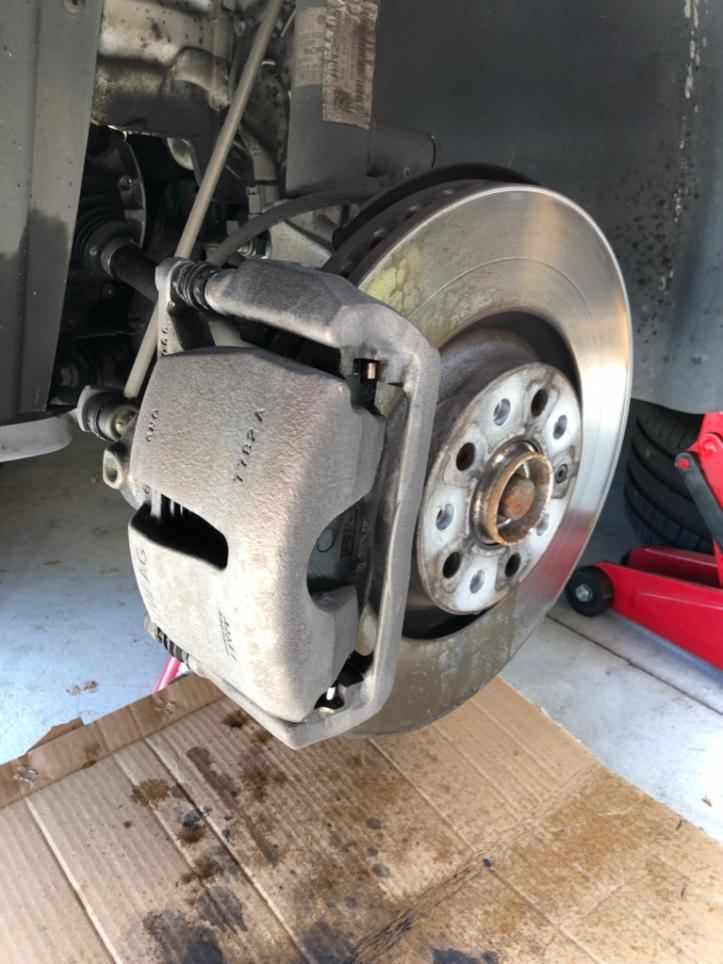

I also bought some POR-15 Metal Prep and this is what they looked like after giving them a good clean with this and then rinsing off:
One thing I did notice after cleaning them is exactly how rough a finish they are.

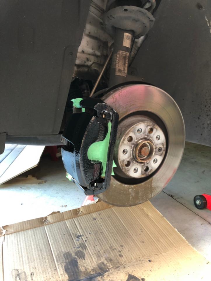

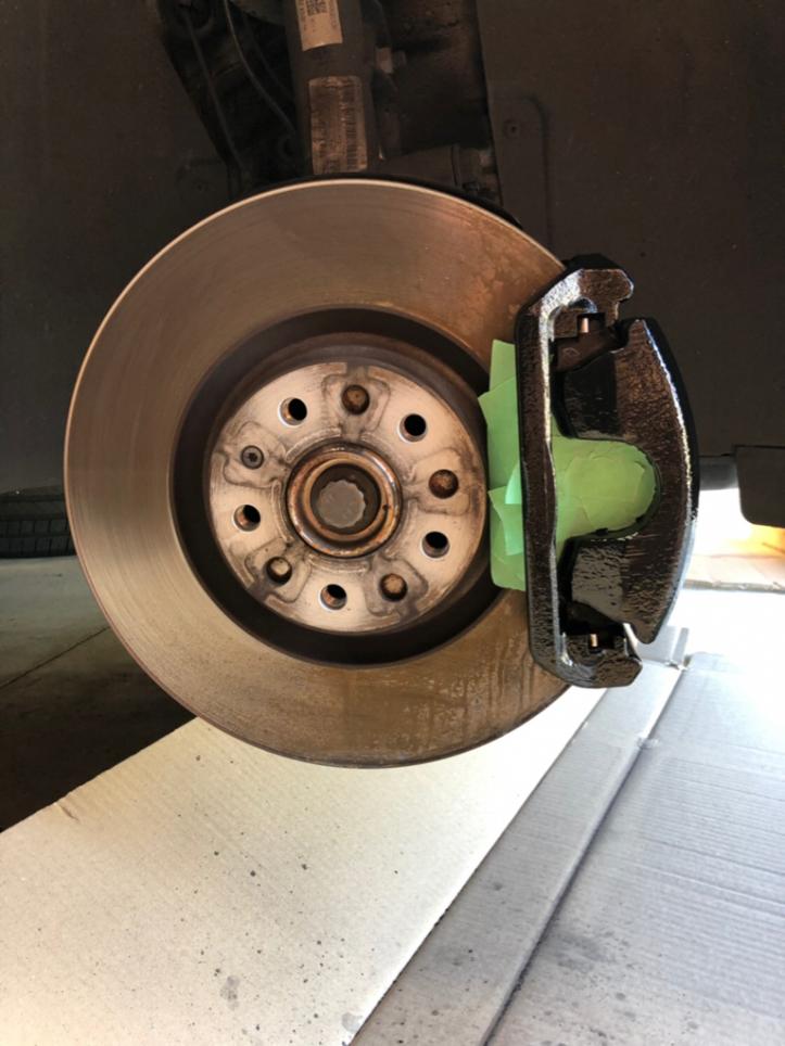

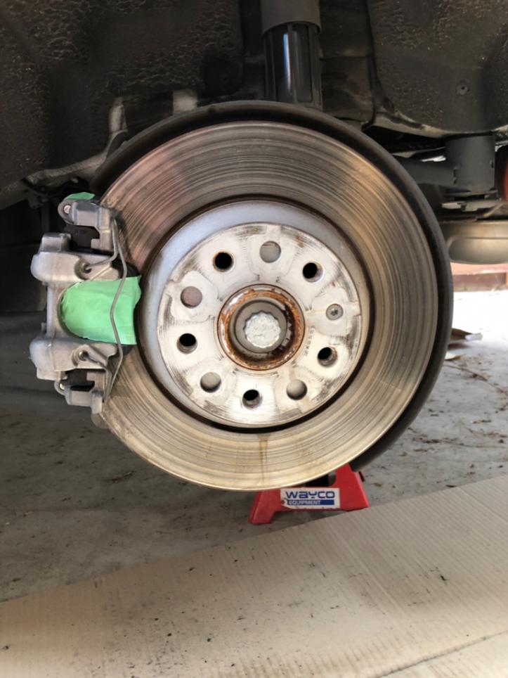

I masked up all the areas that were close to the calipers that I didn’t want to get paint on. Applying the paint is pretty easy and straightforward, I used 2 brushes, a wide one for all the big flat areas then a small one for all the delicate areas. The paint is quite thick and does a pretty good job of self leveling and like it claims the brush strokes disappear. The rear brake are a lot smaller and were a lot fiddler than the fronts. This is what they look like after the first coat:

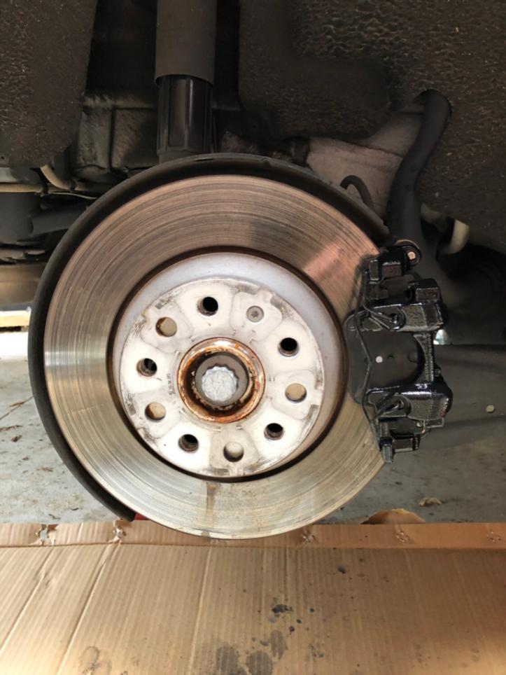

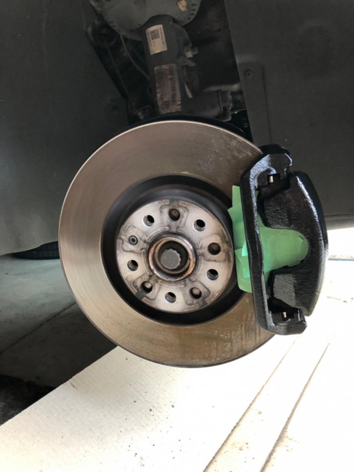

I left the first coat for over 4 hours to dry before applying a second thicker coat which I left overnight and this is how they came out:
Personally I like the look, it seems to have a nice enamel like finish which should make them easier to clean. I did actually apply a quick 3rd coat to the fronts just for good measure and even after doing 3 coats on the front and 2 on the rear I have only used a fraction of the paint, the small pot would easily do more than 10 cars so pretty economical.
