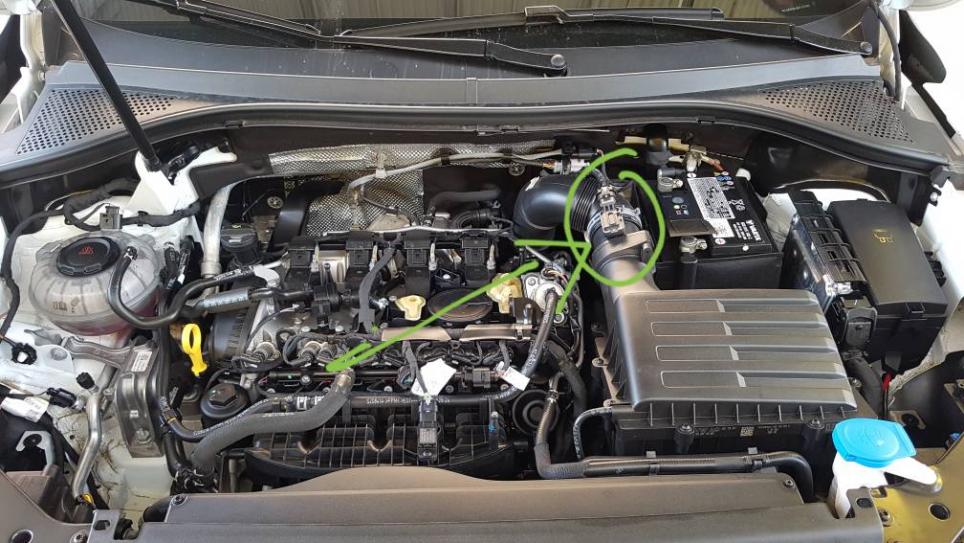

                              I was looking into my engine bay because I wanted to get the Inlet silicone hose and had a doubt where guys placed the maf sensor that is placed just after the air box of our cars???? Sorry for the dumb question LOL
                              Sent from my SM-G935F using Tapatalk
                              • #75
                                My MAF is not located in that location so easy swap to silicon or other inlet hose. Your in Colombia? US spec setup maybe
