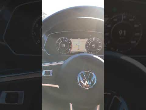

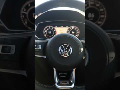

                                Couple of videos, sound does not seem to have fully come through. Had to record on mobile with 1 hand.
                                Sport mode coming onto freeway auto kickdown 60-130km/hr. Huge dsg farts could be heard in the car, cannot really hear it on video.
                                Cruising at 80km/hr in 7th. Theres a constant drone, not clear in video.
