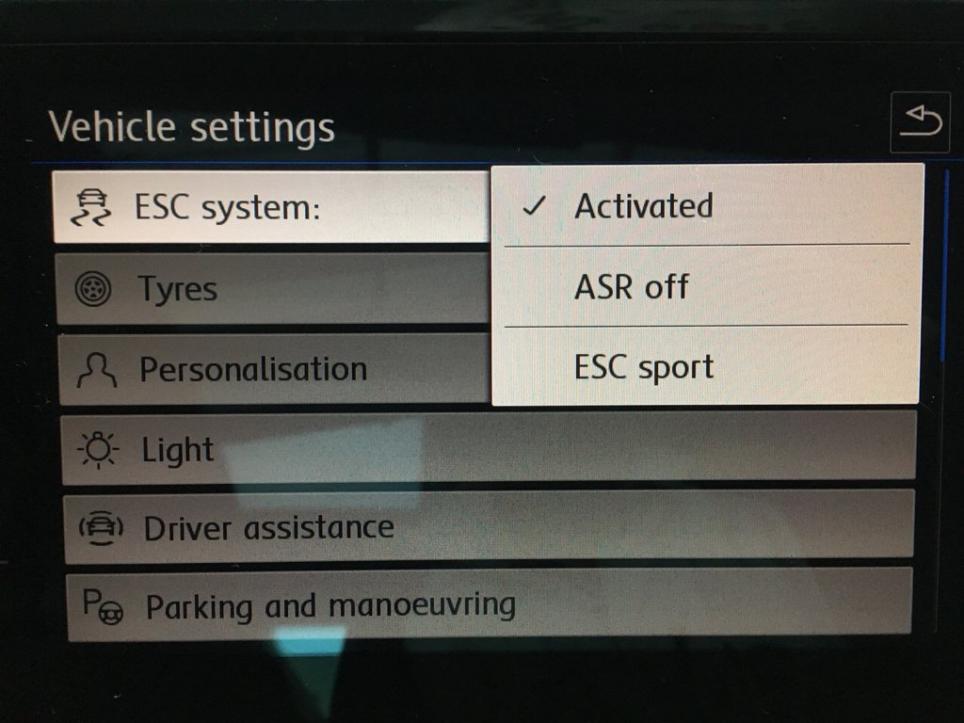

    Hi Ozsko
    With the new MY18.5 have they removed the ESC/traction control button? Do you need to go into the menu to turn it to ESC SPORT? That would be a tad annoying for engaging LC...

        Sorry I missed this, my car is an early one so it has the button and yes on the later cars it is a menu item only.
        • #19
          Gen 2 Tiguan 162TSI launch control
          I haven't launched mine yet but the stability control options are under the settings menu:
          Just select ESC Sport when in "S" mode, foot hard on brake, 100% accelerator, lift foot off brake, go.

            Great, thanks tigger. Are you waiting for a certain number of k’s before trying it out?
