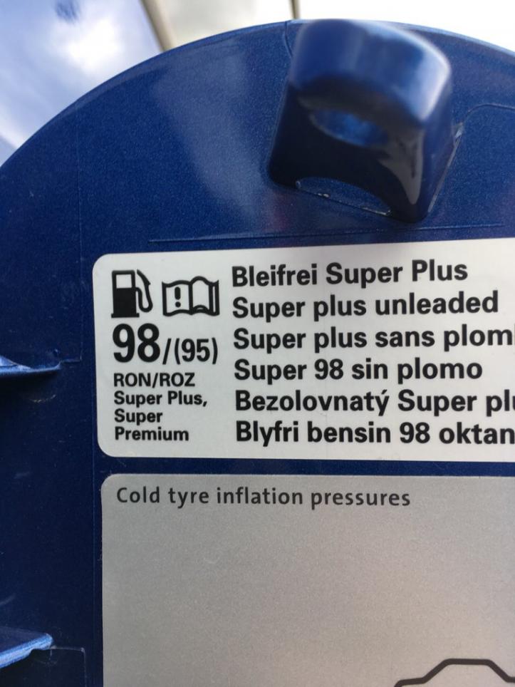

I know all about detonation, I raced two strokes and used data logging to count dets for years. The motor is clearly not designed to run 98 and nothing else if you read the owners manual and the fuel placard on the filler cover, either that or VW made a mistake and put the wrong information out there. I am saying that a statement was made that 95 is marginal, please show me why the statement was made with some hard facts. Are you also saying that VW don't know as much as you? You may well b correct but I haven't seen any hard evidence as yet. In your opinion 98 is the minimum, VW do not seem to share that opinion.
I know the dealers will tell you to only run on 98.
Check your fuel filler flap and owners manual.
If you have a sticker like this it means run on 98 and 95 in an emergency until you can fill with 98.
Not all stickers are the same. My wife’s car says 95. Some models are tuned for 98, some are tuned for 95. There is no consistency within VW on this issue, because different engines in the same family are used in different vehicles.
We should also be consistent when referring to RON, as ‘octane’ is a different rating. VW Aus refers to RON when specifying which fuel to use.
98RON will often be specified on higher performance models in the VW range, whereas standard models will often specify 95. 95RON is the standard fuel in mainland Europe - referred to as ‘Premium’. ‘Super Premium’ is 98RON.
Those who think that just because their vehicle has a sticker stating 98RON is required must mean all VW’s require 98 are simply incorrect in their assumption.Last edited by doc_777; 07-05-2018, 01:55 PM.Cheers
