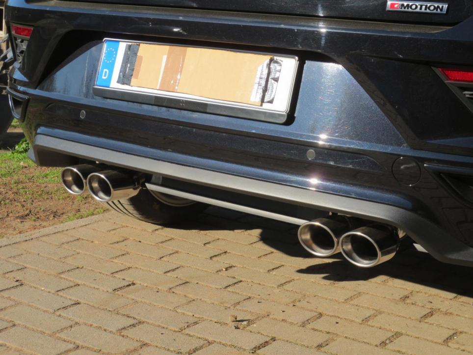

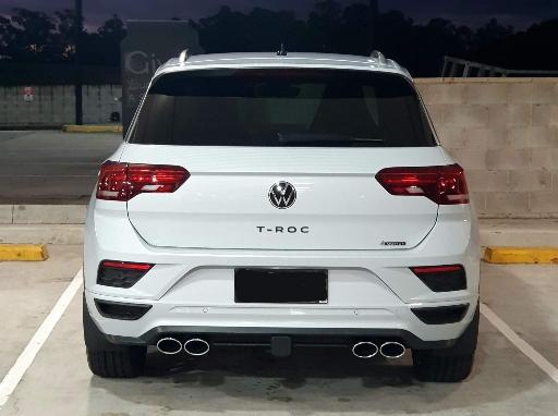

    After reading up on the "Tiguan Exhaust" thread and seeing someone else fit one to their T-Roc successfully, I decided to go down the path of fitting a Golf R exhaust to the T-Roc (and blacked out the horrible fake exhaust tips). Keeping in mind the T-Roc is just a Golf on stilts, the only modification needed was a reducer and moving the tips in towards the centre of the car (as the T-Roc rear bumper opening is narrower than the Golf R).
    The outcome was exactly what I was after - a small increase in sound and something that looks OEM.
    Interested to see if anyone else has changed their T-Roc exhaust?

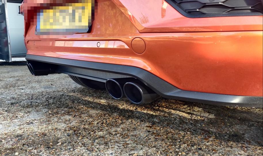

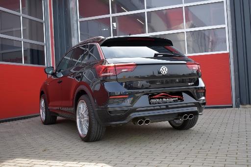

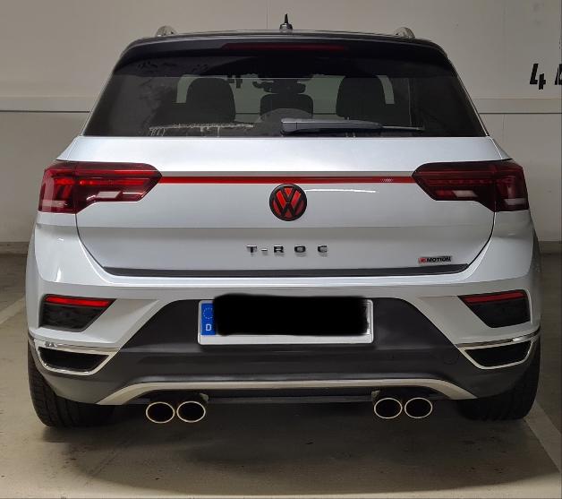

    A few other photos of T-Roc aftermarket exhausts from my research.
      I am very keen to go down a similar route with my T-Roc and will talk to my guy in the coming weeks. Will look into whether we can source a decent used system, or may have to go down the new aftermarket route. Tassie being such a relatively small market can make obtaining some parts difficult.
