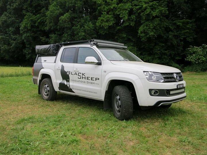

They would need to be banded to fit 265/65/17 on them. As far as I'm aware they are +53 and 6.5" wide. Banding them an inch would bring the offset closer to +40 which would be ideal
Over on Ausamarok there is a fellow with these 17" steelies and colour coded Bushwacker flares. Happens to be one of the few red ones too (like mine)

Yep that's where I saw them initially but only saw them recently on a White Rok (above) and mine is white. Just exploring the options for new rims, my dynamic or king or whatever they are about to go in the bin!
