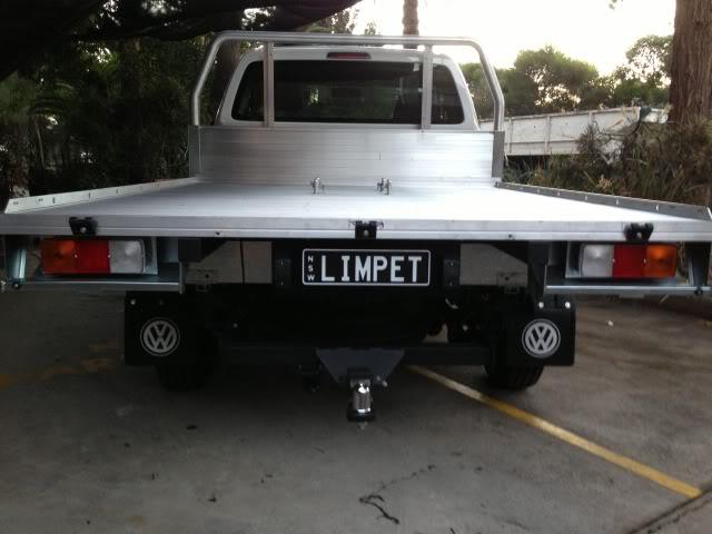

        I got mine factory fitted at delivery. Complete with loom and all the trimmings , believe it was around $1300.
        Mines a tray back though.
