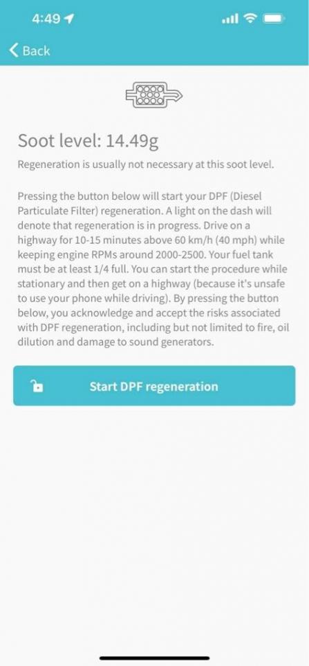

      Carista OBD2 users- DPF Regen Amarok V6
      This is not my photo, but this is what the DPF info looks like in Carista. Just a very simple soot mass calculated number (you will get to know your car to know how many grams is full) and then a ‘Start DPF regen’ button. But this is all the info you need really.
      As for your other questions…
      I have the paid version and its been years since I used the free one - so can’t answer what you can do in the free version…..but i dare say this is classed as a ‘premium’ feature.
      I have never tried to use Carista with no phone/internet service.
      As an FYI the $80 it costs to have a 12 month subscription to Carista is just loose change compared to the cost and inconvenience of a trip to a mechanic.
      As for the ‘DPF monitor for VAG’ app, i just purchased this app a few weeks ago. Its good and tells you info from the various sensors, but you cannot trigger a regen using this app.
