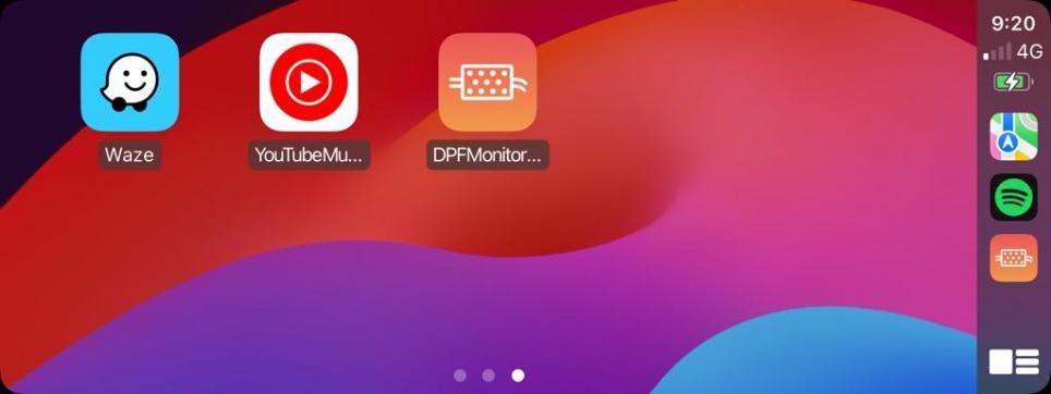

    • #17
      DPF questions
      Update on the DPF Monitor app for iOS Apple devices as discussed in my previous post above. It appears to look and work in an almost identical way that VAGDPF does - which is a good thing. So for those people who are on Apple devices, this is a good option and definitely worth the $10 cost for the app. It also works on Carplay which is great.
      Only downside is that you cannot trigger a regen using this app - you can only monitor the DPF behaviour and health.
      I will use a combination of this app and Carista going forward, with Carista being able to manually trigger a regen at a time that suits me (eg not when im 5 mins away from home after just spending an hour on the freeway at 100kph).

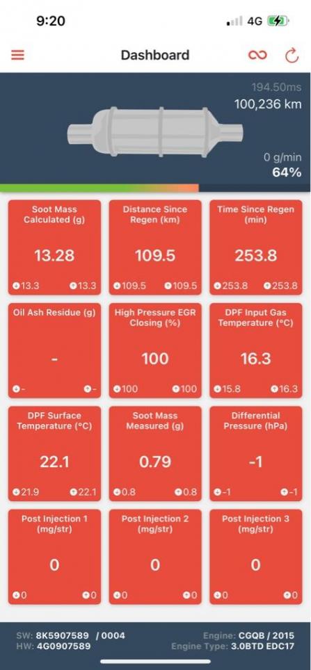

      • #18
        And for comparison, here is a screenshot of the VAGDPF app on the same car. Note both apps have several parameters on my engine that cannot be read.

                                Thanks, I was wondering why we had such a discrepancy between the two figures on some occasions. Strange that the Actual/Measured soot mass gets ignored though still resulting in the same outcome where the regens are triggered by a 100% calculated load more frequently than expected or what is actually there.
                                Is this a precautionary measure by the system running two measurement models and erring on the side of calculated mass to initiate an active automatic burn?
                                I wonder whether the sampling tube(??) between the two pressure sensors is the root cause of a lot of issues.
                                If this gets clogged resulting in more rapid buildup / pressure differential than what is actually occurring in the DPF (measured load)?
