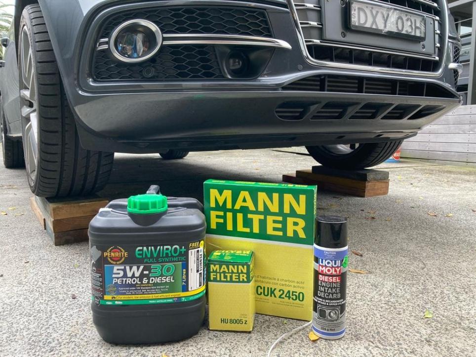

                No oil consumption at all on my engine, but its quite young and has only done 65,000km.
                I check the oil at least once a month to check the level and general condition of the oil - its always on the full mark.
                So my VW/Audi specialist services the car once a year for me (which is about 12,000-14,000km) and he uses Fuchs Titan GT1 5w-30 oil, then 6 months after his service I do my own oil and filter change and I use Penrite Enviro+ 5w-30 which is readily available from Supercheap/Repco etc and on sale several times a year so that's when I buy it.
                So the car gets fresh oil every 6 months or so and 6,000-7,000km.

                      @ Lucas_R
                      Thanks for the detailed info on oil & filters.
