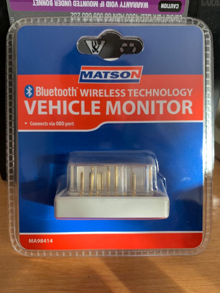

      I picked this one today, just to play with it. But, it didn’t want to pair with my iPhone XR, it connected with my old Note8, but it didn’t communicate, most likely doesn’t have the right protocol.

        It depends how much do you want to spend.
        The VCDS from Ross tech is the one that’s more suitable than others. The OBDEleven has similar menus, but you need internet every time you use it.
        Keep in mind that the generic OBD2 readers aren’t best suited for scanning the diesel, since you get very limited information.
