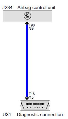

        As to which of these inputs to J234 was the most critical in the decision to deploy the airbags, the answer can only be found by interrogating PIN #15 (see the wiring diagram below) on the car's OBD port using a special device - which is very different to diagnostic devices that lot's of us "nerds" use (like VCDS)
        Unfortunately, the cost of even the most basic airbag control module reader (see HERE) is about $5K ($AUD).
        So, here's the real question - how badly do you want to know the answer to your question?
