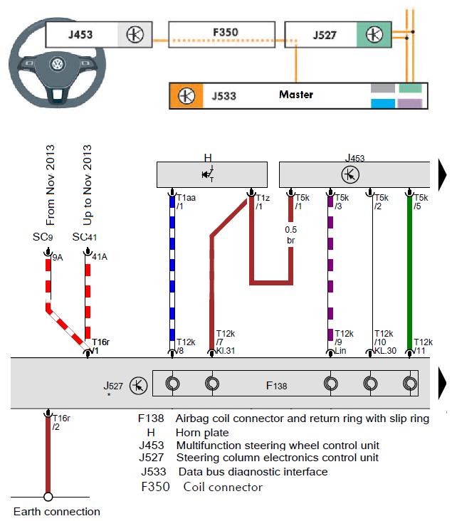

I have a 2013 mk7 highline tsi, and have recently had an issue that I need help with.
Last week all electrical controls on the steering wheel stopped working, however, the horn still works.
I'm thinking it could just be a fuse, but the manuals information on fuse location isn't accurate.
Any help/suggestions is greatly appreciated!
