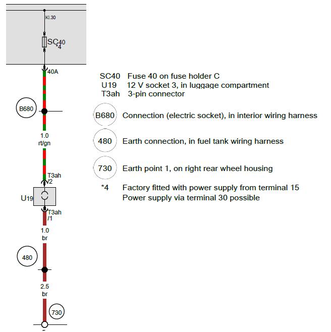

      Here's the OEM wiring arrangement for the rear 12Volt socket. Note SC40 is the same fuse that supplies the ciggy lighter power in the centre console.
      Don
