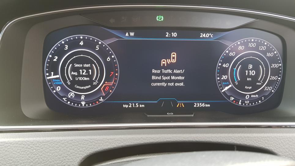

          • Anyone know why I get the error message below - I cant get Rear Traffic Alert & Blind Spot Mon to stay turned on?
            As soon as I put the car in ref gear this error comes up and both the above turn off?
            Very annoying that I cant get it to stay turned on...

              Hi frostywinter, I had exactly the same issue with my 7.5 GTI. I had to book an appointment at the service centre and got it fixed yesterday. Apparently some coding was done incorrectly at the factory. They recoded and has been working fine so far.
              When you engage reverse gear, do you get an option to choose parking mode on the MFD? User manual says you can but looks like that's not available in AU spec cars.
              • Hi Facelift, when I go into Rev gear (DSG) no I dont get any options, just the posted screen shot error pops up for a few seconds.
                This problem has only happened since I disconnected the car battery while I installed a sub woofer - was working fine before doing that.
                Must have something to do with that I am guessing as there were numerous error messages after starting the car the first time after reconnecting the battery - they all went away after a short drive and restarting the car for a 2nd time, but this error still is there..
                Looks like a trip to the dealer?

                  Hmm, that's interesting. Now that you mention, my battery was also disconnected while tinting (to prevent airbags from popping when the small glass in the front was tinted). I also got a whole bunch of error messages. However, I hadn't driven the car much before tinting was done and hence I assumed it was a factory coding problem. Looks like disconnecting the battery messes up coding.
