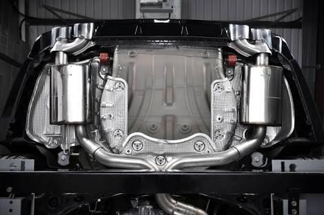

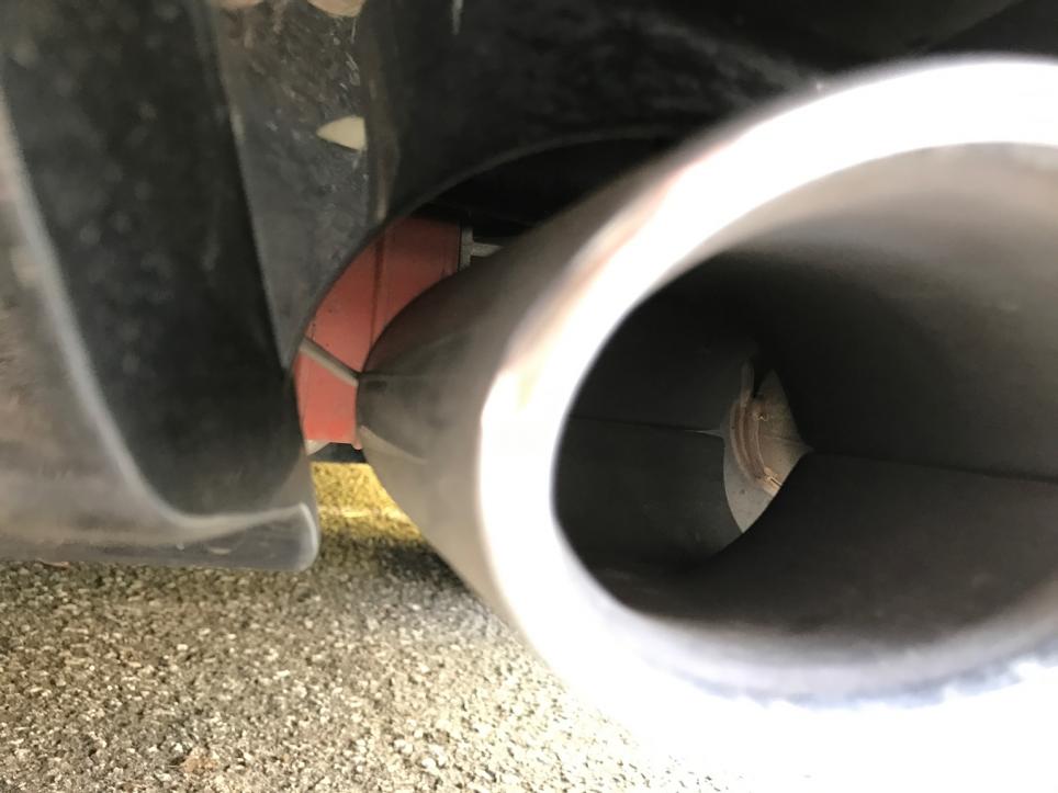

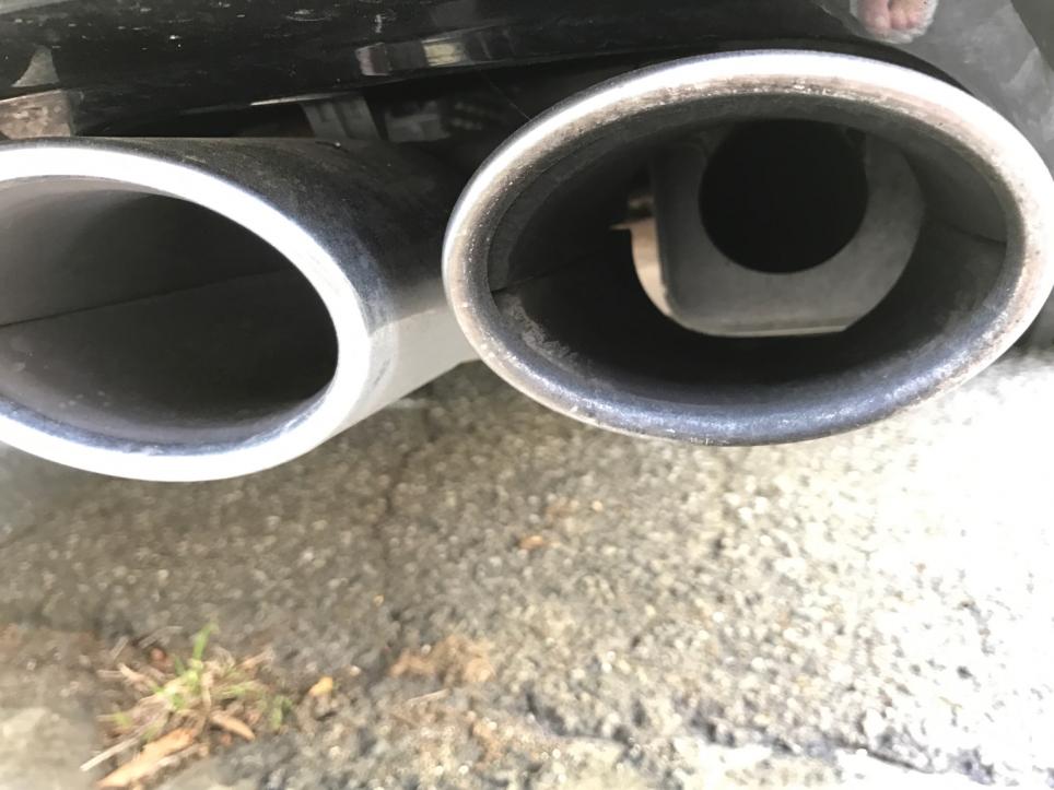

    If you have a close look at the exhaust above you can see something similar to Quad piping in the RS3. That is because like the Golf R the 2 outside outlets are only active when the valve is open for sports/dynamic mode.
    So the good news is the R is the same. The bad news is I don't know of any products that exist to convert it. You would have to look into custom exhaust tips as far as I know.
    That would involve cutting off the ends and welding in something similar to a Y pipe to a large RS3 like tip. The benefit of doing it that way is the change stays cosmetic and no mechanical changes would be required so you can keep the Sport Valve for when you want to hoon and the quiet mode for when the wife is in the car.
    It is unlikely to noticeably change the sound, but I reckon it would look awesome especially if they are the nice big oval stainless steel tips the RS3 has. As a benefit the carbon build up on the pipes would be even too haha

      This is a Milltek system, but the piping is very similar to what I was talking bout earlier

                The R wagon owners don't even need a closing Y adaptor as there's only one pipe out of the final muffler.
