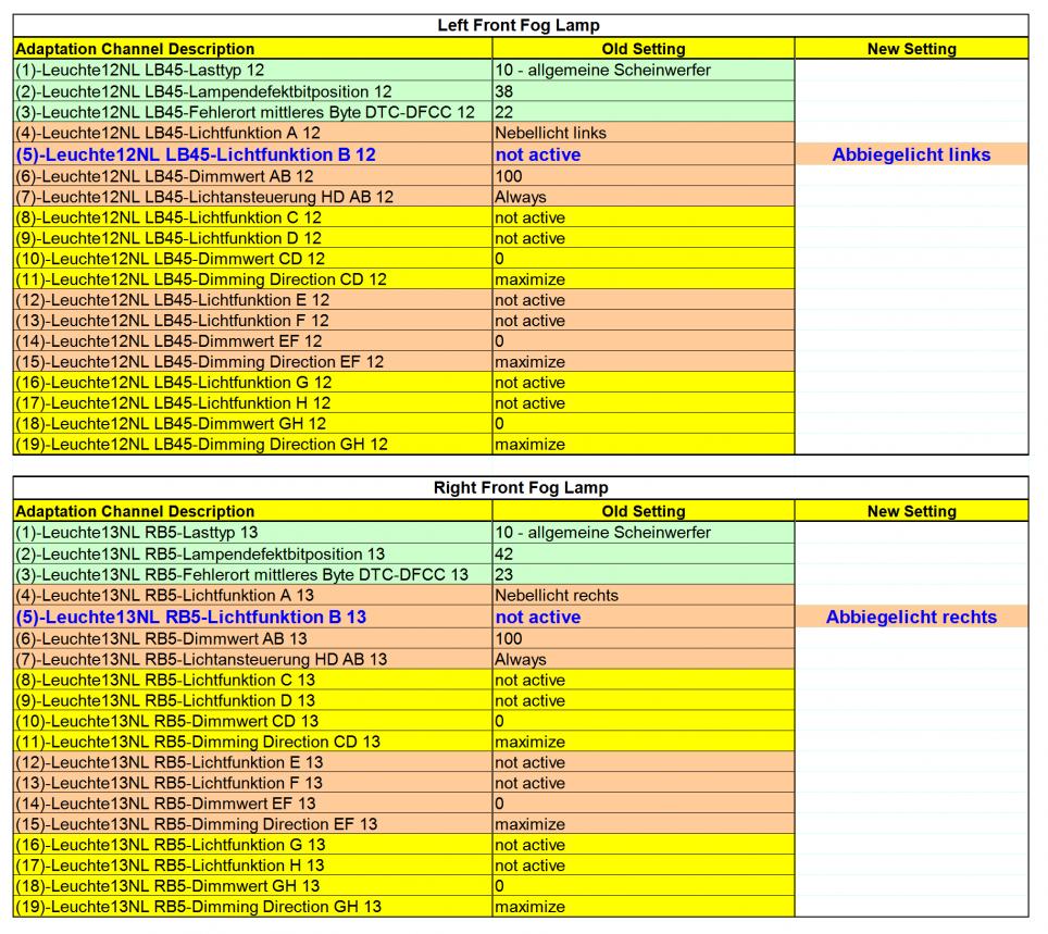

        Merlin: OK, had a quick look at the admap for the BCM on my car and here's what I think:
        1. There don't appear to be any specific adaptation channels devoted to the steering wheel angles for the static cornering lights. I suspect that the BCM uses the settings for AFS (Advanced Frontlighting System that is used for dynamic cornering on HID headlight fittings). All the admaps in my database have the AFS pre-set as default (regardless of whether HIDs are fitted), so I'm guessing (hoping) that your BCM is similarly coded.
        2. I've manufactured (guessed) how the two Leuchte-sets for the left/right fog lights have been set-up by the factory in your car. If my hunch is correct, your car should have the "old settings" shown in the tables below. You must check that my guess is correct and If I've erred, please provide feedback.
        3. The tweak instructions are as follow:
        1. Select 09 - Central Electr control module
        2. Select Security Access - 16 from the "Open Controller" screen
        3. Enter the magic number 31347 and return to the "Open Controller" screen
        4. Select Adaptation - 10 from the "Open Controller" screen
        5. From the pull-down button check that the default settings for the adaptation channels shown in the table below are as indicated in the Old setting column. Use the "search box to find the correct Leuchte channels
        6. Change the two Leuchte channels depicted in the table below to the values in the New Settings column. Don't confuse the new settings with Abblendlicht links/rechts command - the two may look similar, but they are very different in their functions
