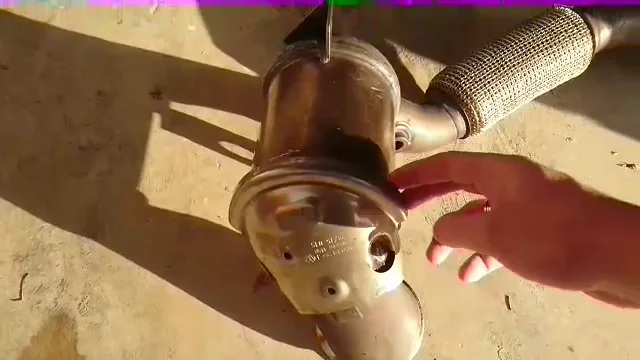

    Ok guys, well I have good news and bad news.
    I'm pretty sure I've found the source of the rattle. The bad news - I don't think it's going to be easy to fix, without removing the dump pipe to fix, or by replacing it obviously..
    The rattling sound sounds suspiciously like the metal shroud/cage around the downpipe flex joint. Unfortunately this will be pretty difficult to access without removing the downpipe. Likely why VW wont release a 'fix' for it, because its at least 3-4 hours of work just to get the downpipe out!
    I made a quick video to explain:
    This is "1449648447" by Primordial on Vimeo, the home for high quality videos and the people who love them.

      Originally posted by andrew7 View Post
      Thanks Jon, great detective work. It's looking more and more like a new DP is the way to go  (and therefore an intake and tune as well  )
      Well, there's a couple of other great reasons as well! Fixing the rattle was just a bonus
      Originally posted by rosslm View Post
      How about titanium insulation tape around that flex joint, it may muffle that clanging sound is it possible to get access to apply the tape in situ
      Potentially, yeah. I'm trying to remember back when I had the car up on the hoist. I do remember seeing the flex joint in-situ, but I can't remember if it was accessible or not. You may be able to get to it without taking it out, and yeah, the titanium wrap would definitely sort the issue out!
      You can definitely get enough clearance with a standard car jack to take a look at least. You will probably have to remove the plastic undertray to be able to see up there though. It's pretty easy, there's 7 torx screws to detatch the undertray.

        Hi Jon
        Thanks for the video. To me the sound when you tapped the heat shroud is much closer to what I'm hearing - it has that sort of resonance where the sound lingers slightly rather than the scratchiness of the heat shroud.
        Is there anything around the heat shroud it that might come into contact with it?

          Originally posted by TFAD View Post
          Hi Jon
          Tom (TFAD)
          Hey Tom, from memory no there's nothing that comes close to the heat shroud for it to vibrate against.
          I would be extremely surprised if it was the upper heat shroud causing the noise (unless you're hearing a different noise?). It's almost certainly the mesh cage vibrating, in person it sounds identical to the rattle I was hearing. What you have to remember is that the mesh cage is vibrating at 40hz roughly (2500rpm/60 secs). It's going to sound like a 'lingering sound' as the revs increase and the cage moves out of its resonant frequency.
