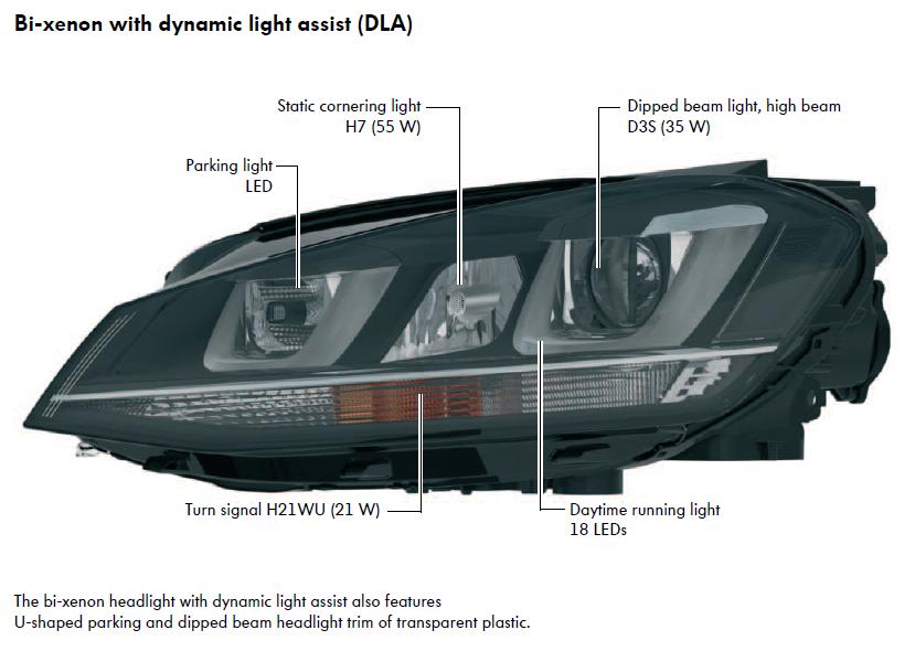

    Ralfi: hello. In answer to your question, there are the following different versions of the headlights available for the mk7:
    1. Halogen headlights
    2. Bi-xenon headlights
    3. Bi-xenon headlights with dynamic cornering light (AFS)
    4. Bi-xenon with dynamic light assist (DLA)
    Below is a description of DLA headlight from VW:
    Technical features
    The dynamic light assist (DLA) incorporates the dynamic cornering light (AFS) and dynamic main beam control (MDF) functions.  The layout of the bulbs and the appearance of the bi-xenon headlight with advanced frontlighting system (AFS) and dynamic main beam control (MDF) is the same as that of the bi-xenon headlight with AFS. The design of the inside of this bi-xenon headlight is, however, different. It features a group of individually moveable screens which can be swivelled into the light cone cast by the main beam lamp.  The dynamic main beam control function, that is, the partial masking of certain areas of illumination, is implemented through a combination of the screens and the horizontal adjustment of the module
    Hope that this helps

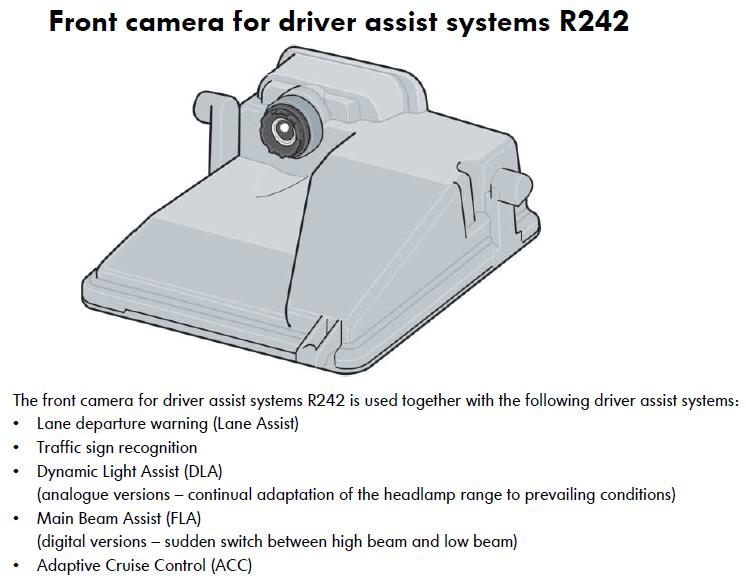

        beingaware: very true!! The camera is what VW call R242 (it's mounted on the windshield in the RLHS housing- I believe)

            You have type 3.
            Which has the static turning lights.
            To enable DLA, you will need the DLA RHD headlights, the isight camera and a new windscreen as our AU spec golfs have tinting where the camera would go.
            Then at install, you would need vagcam to enable the feature.
            I'm in the process of Euro Speccing my Golf R, the cost to get DLA which also enables lane assist will be around $3000.
