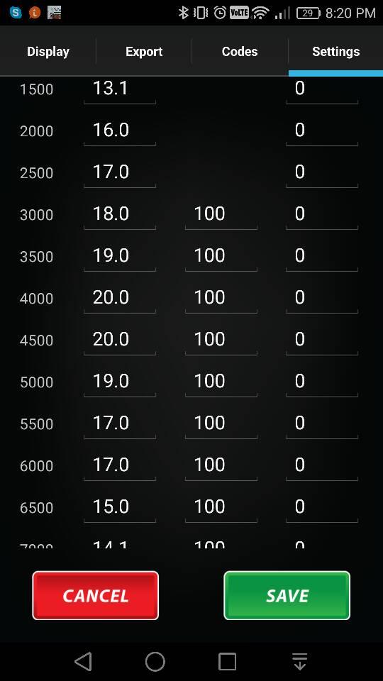

            Skoda RS230/GTI PP with JB4, DP, HPA Puck, intake & pipes with stock wheels 19s. Has 16,000km on it.
            Started to slip on the way to dinner tonight at 2500-3000rpm on map1 (+4psi over stock). Did a couple of runs on the motorway to confirm it.
            I have a map6 (custom and attached) that has a slow boost curve, which isn't too bad, but it will need replacement.
            I've read good things about the South Bend stage 3 on here, but I'm interested in Harding Performance clutch kit as I'm in Brisbane.
            DMF or SMF seems to be the major question. Hardings is SMF.
            Mate with same car has the Hardings clutch kit and loves it, but after more than 1 opinion.
            Thanks Team!!
