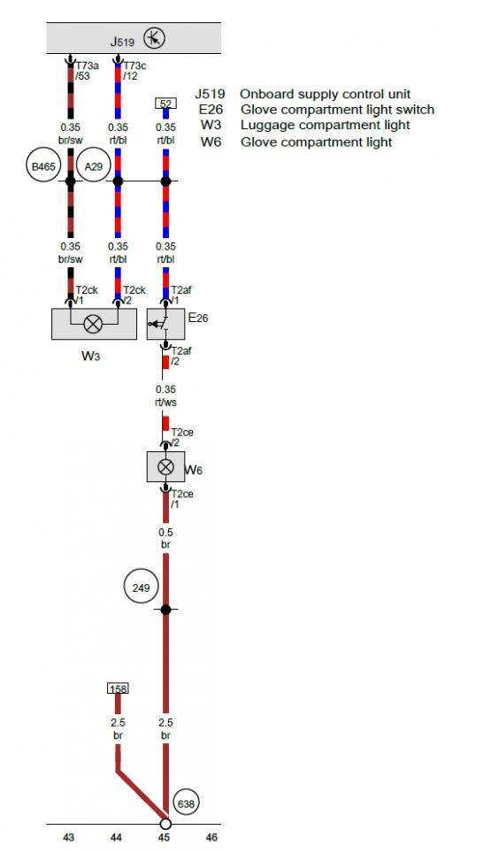

^^^ Not sure if I'm reading the posts above correctly, but there is little risk of the possibility of an "afterglow" on the glove-box light!
Here's a section of the wiring diagram for both the glove box light and the "luggage compartment" light (which is the lamp in the hatch)
As can be seen, the Luggage lamp (W3) wires get directly connected to the BCM (J519). The switching for this lamp happens on another BCM pin so it's possible for an afterglow to occur because of whatever embedded circuitry is connected inside the BCM on pin 53a and pin 12c.
However, the glove box lamp (W6) is wired in series with the glove box switch (E26) which is a mechanical single-pole-single-throw device. Ain't no way that any leakage current can flow through the glove box lamp when E26 is open -regardless of whether the lamp is LED, or incandescent (I think).
DonLast edited by DV52; 29-07-2016, 03:54 PM.Please don't PM to ask questions about coding, or vehicle repairs. The better place to deal with these matters is in the forum proper. That way you get the benefit of the wider expertise of other forum members! Thank you.
Don
wow, yeah there's no chance there!
if it does glow then you've got bigger problems
