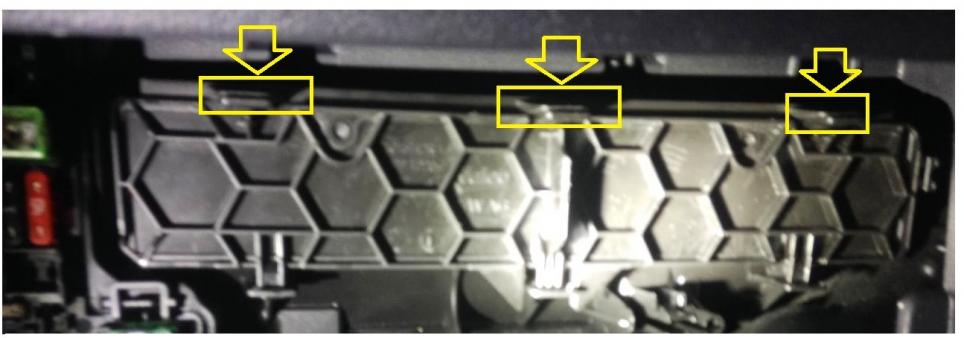

            Hi Team_V,
            Sorry for raising an old thread. I have googled until frustration set in, scoured several forums, and still can't work out how to get the pollen filter out. It can't be as hard as I'm making it!
            I was wondering if you could help me workout how to get the pollen filter out of it's housing? I've located it behind the glove box, but I can't work out how to release the door. There are 3 clips holding it in place, although it seems that if I lever those down they will be damaged due to the stress... are you able to articulate how the pollen/cabin filter is removed? I've attached a photo of what I see after I lower the glove box.
            Thanks in advance.

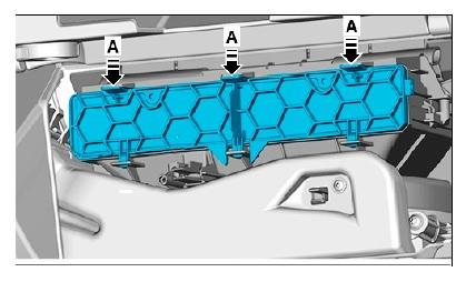

              wht90TSI: I hope Team_V doesn't get too upset if I steal his/her thunder (it's most definitely not a good thing to upset a super-moderator-LOL) !! But, the trick to removing the pollen filter is to GENTLY press down the three tabs at the top of the cover (not the tabs at the bottom). I have used a small steel ruler (or flat-head screwdriver )- get it between the cover tab and the mating tab on the base and lever the two apart (GENTLY). If you start at one end and lodge the tabs apart one-by-one, it shouldn't be too difficult. But be gentle!!
              I've tried to show the tab locations on your pic, but it's not too clear.
              The pic below shows the tabs a little better.
              Hopefully the two pictures together will suffice

              • #22
                Thank you so much for your quick and detailed response. It's so easy once you know how to remove it - needless to say it came out without an issue!
