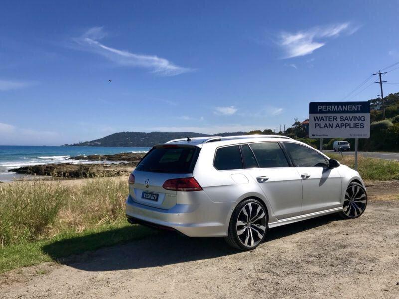

Specs on the Suzuka are 20x8.5 ET38 so you'll have to run something like 235/30R20 to fit to a Golf. It'll poke around 18-25mm more than stock (depending on what stock rim you're running) so get ready with your guard rollers - particularly if you're lowered.Originally posted by sVWatt View PostThanks guys. My partner has the Tig with these and it has a nice presence about it. I thought they would look awesome on my Golf. Might sneak out in the night and swap them over
Not as bad as I thought (although I don't know why I thought it would be much different to those specs) - that's achievable. And obviously was.Originally posted by tigger73 View PostSpecs on the Suzuka are 20x8.5 ET38 so you'll have to run something like 235/30R20 to fit to a Golf. It'll poke around 18-25mm more than stock (depending on what stock rim you're running) so get ready with your guard rollers - particularly if you're lowered.
Nice one, thanks for posting up. And a wagon to boot.Originally posted by strel View Postjust put Audi Q5 wheels on my mkVII golf wagon. Specs are 17x8 et39 with 225/45/17 RE003's.
quite happy with the results, flat design suits the flush look.
