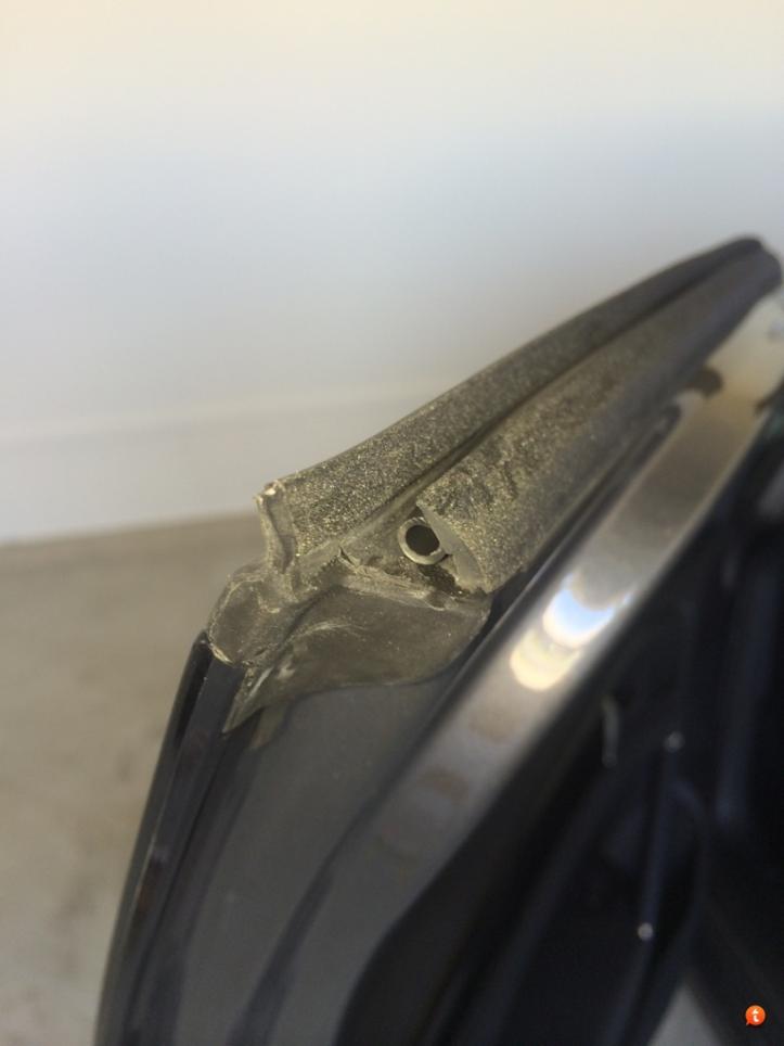

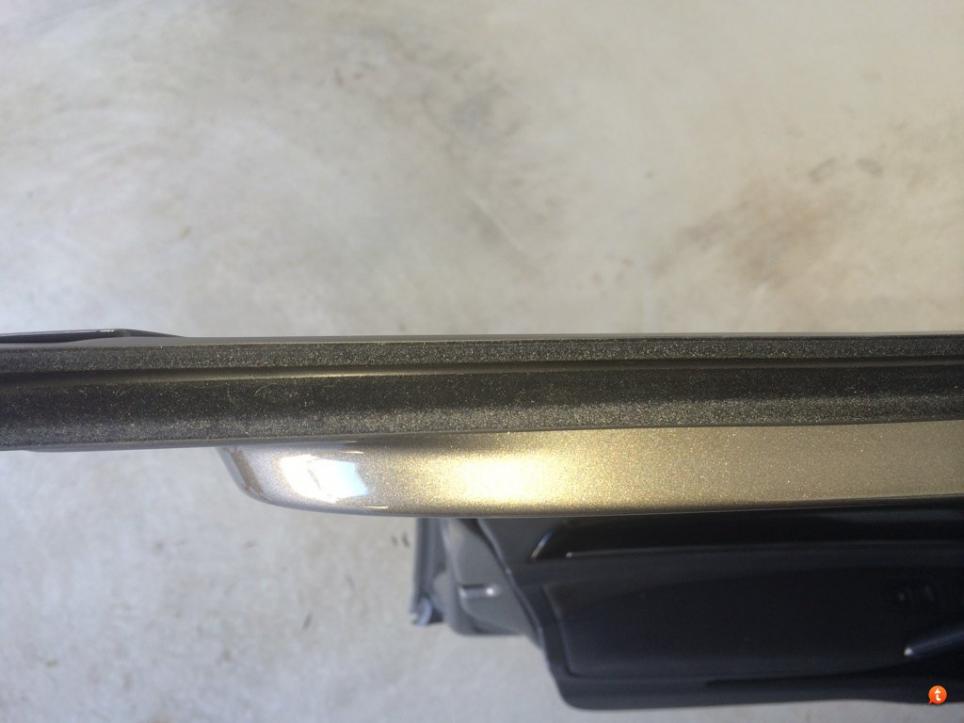

                  Dutch77 could you please put up some pictures of the pipe and where you put it
                  Pretty sure there's some better pics in the thread Adam has referenced, but here is a really bad pic of where the tubing goes - I just held my leftovers up as some kind soul unwound the whole roll and threw away the packaging. It's the non-flexible 4mm irrigation tubing which as a bonus I used in the garden as well.
                  Assuming the 7 is the same as the 6 and current Polo the door seal is in two parts and the pipe slides between the two. The seal should still be tight enough to hold it in place. I'd go all the way along the seal on all doors. On the 6 it ended the creak on all bar the most angled of driveways and I never replaced it or had it fall out.
                  (I've demoed this on the mrs' Polo which is making way for my new Dub)
                    Went to bunnings and got the irrigation pipe and installed it in the door seals.
                    Worked 100% perfectly!! Best $3.95 I have ever spent!
                    Recommend it to anyone who is having the creaking sound in their cars.
