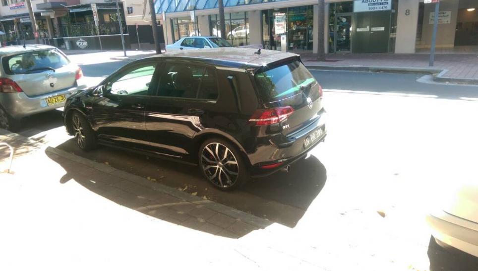

                A quick update, they haven't been able to find a fault and have given me a GTI PP for the night to drive across the same roads and bumps that make the knocking noises in mine.
                At the same time I told them about what you mentioned was changed and they said order it and change that as well see if that fixes it. They've ordered it and said the control arm will be delivered tomorrow and they'll fit it tomorrow. Fingers crossed!
                I've got to say their service has been very good, they want it done as much as I do so I don't keep coming back.

                                So far so good mate, after all the trouble shooting and replacing all other suspension connecting parts, they've replaced the lower control arm (Huge thanks for the advice!!!) and after a day and a half of driving it looks resolved! Quiet suspension is mine! fingers crossed! Thanks again for the advice.
                                Interesting comparison to the GTI PP they lent me, had it for 2 days and biggest difference apart from the diff for traction was the lower road noise from the Pirelli P-Zero's, they are much quieter than the Bridgestone's on my car, (pirelli's had 6500kms vs my Bridgestones have 15600kms) and my Bridgestones have plenty of tread left.
                                Think come tire time, I'll look at my options. Namely GoodYear and Dunlop cause I can get them through my family's GoodYear Autocare - family rates
