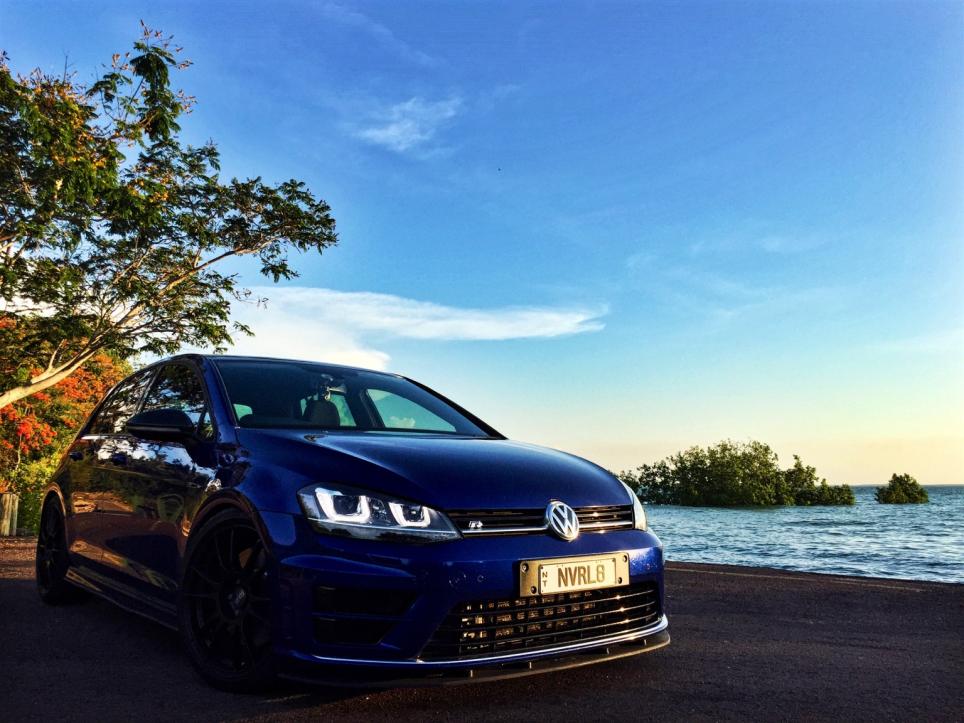

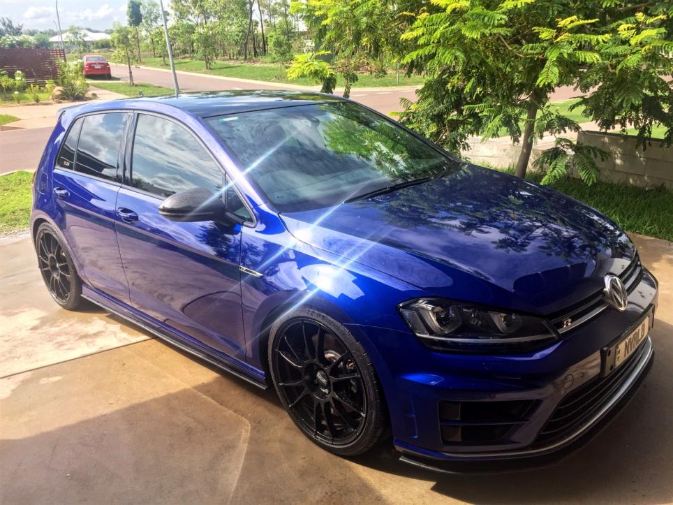

                              I have the front and V1 sides. Looks good. Wasn't so keen on the rear after seeing in person .
                              For the front bar, take it off or jack up at the front. Have 2/3 people and whilst one holds in place the other person drills the holes. Can use tape to help in holding in place as well. Then outside 2 screws in and easy from there.
                              For the sides jack up and pull the skirt away slightly(kind of pops out/in) as it will give your fingers some room and again someone to hold in place and drill etc.
                              Here is 2 photos of mine. The sides you can get them to hang out as much as you want.
                              • Hey sekas,
                                That's great feedback. I agree on the rear set and having not seen them first hand I was unsure of the styling. The fact that you haven't fitted them was the evidence I was looking for.
                                I think I'll proceed with the front and sides.
