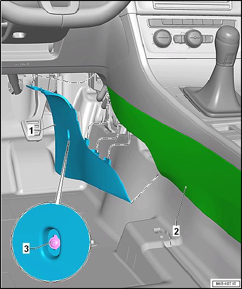

      Do you know where I can find access to it on my car? I can't see it after removing the glovebox or near my drivers kick panel which is what I've seen on youtube. All the links I see online or videos on youtube are for LHD where i'm trying to find where it is on a RHD golf.
      Thanks
        clinton: OK - if you are sure that is the piece!
        To access the Temperature flap control motor on a RHD car, you just need to remove the center console trim in the footwell (the trim on the side of the console body. Below is a picture of the trim on a LHD car (I couldn't find the equivalent for a RHD car):
        Then follow the instructions HERE
