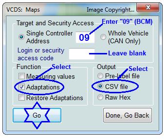

        hmm..... OK - sounds odd Rather than starting a dance of successive guesses -probably better if you create a BCM adaptation channel map. Load the file on a third-party hosting web-site and include a link in a new post here
        Set-up the admap dialogue box like this:
        Don
          Don
          Alright, Don
          I will do it after 5 hours, when i back to home and attach the cable to the car.
          Done - the map on ch 9
