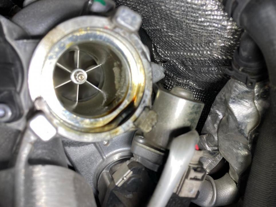

    Hi i have a 2014 90 tsi 1.4 and had the Epc light come on today and had a look at my throttle body when i came home and found oil in pipe and oil near turbo side and some throttle side .What do you think i may need repaired and would this have this caused my high oil consumption ?

    That small amount of oil is normal to be there.

        FYI this is my turbo at 50,000km when i was fitting a new intake. Its just oil getting though the PCV system. A good quality aftermarket oil catch can system will drastically reduce this happening.
