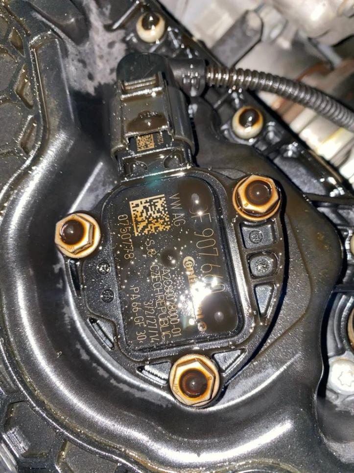

    Hey folks, just want to confirm if anyone knows if this is the course of the oil leak. It looks like it but not sure if it could be coming from anywhere else above this item.
    2015 Golf R. Lapiz Blue.
    From that photo it looks like its coming from above the oil level sensor and running down. Give it a clean off with some degreaser or brake cleaner and check it again in a few hundred km's.
      Yeah I think you are right. Looks like my sump is leaking as this is higher than the sensor. I’m hoping it’s just spray from the sensor. I’ve ordered a new O ring for the sensor. Is fitting a new sump a big job if it is this?

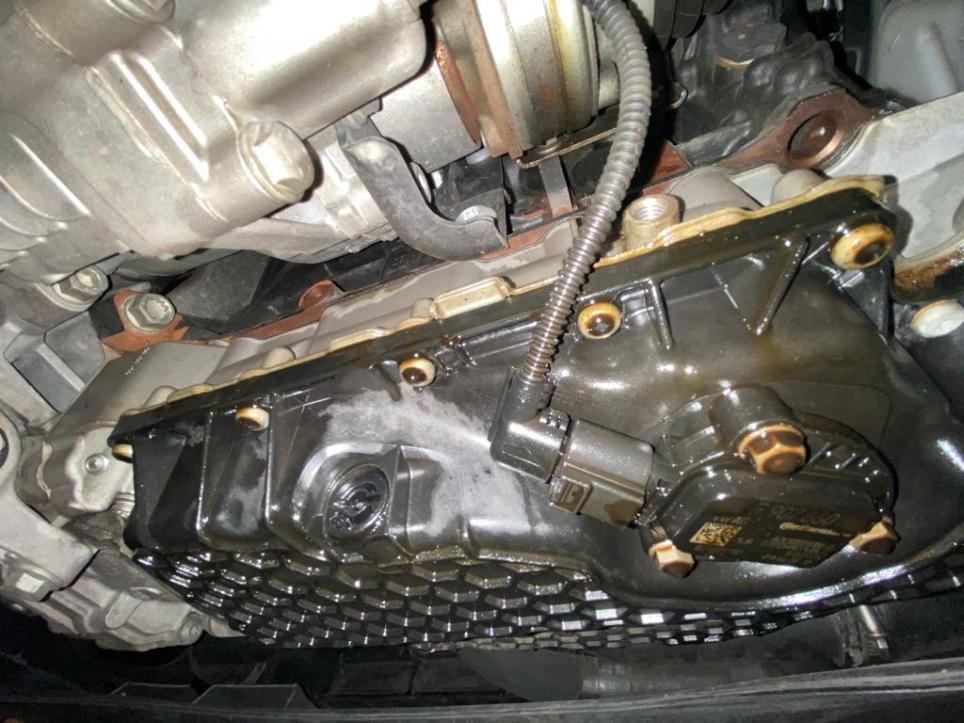

        Update. Managed to get a photo from the back. Looks like it’s the oil pan.

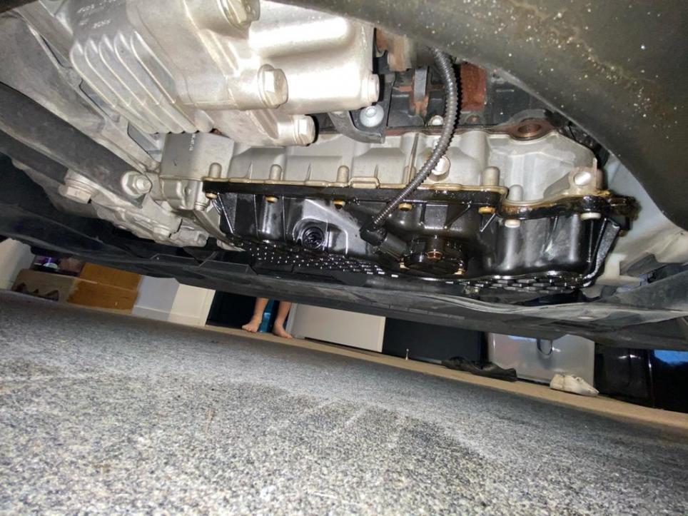

          Another one.
            It's not the level sensor. The sump has a rubber seal. Easy enough to take out the T30s and refit. Need to drop the oil though.
              Thanks for that. I nearly bought a new sensor but when I took the photos from the back I could see all the oil from the seal.
