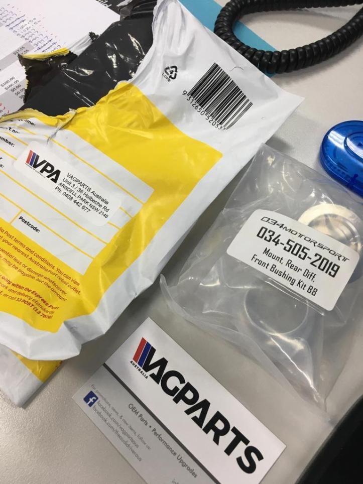

                              Originally posted by PeteRepeat View Post
                              Hopefully I can get a pump earlier next week but haven't heard from vagparts yet....
                              Ordered yesterday, delivered today. Love me some fresh VAGParts.
