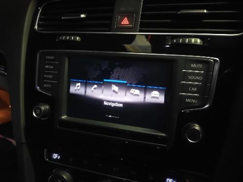

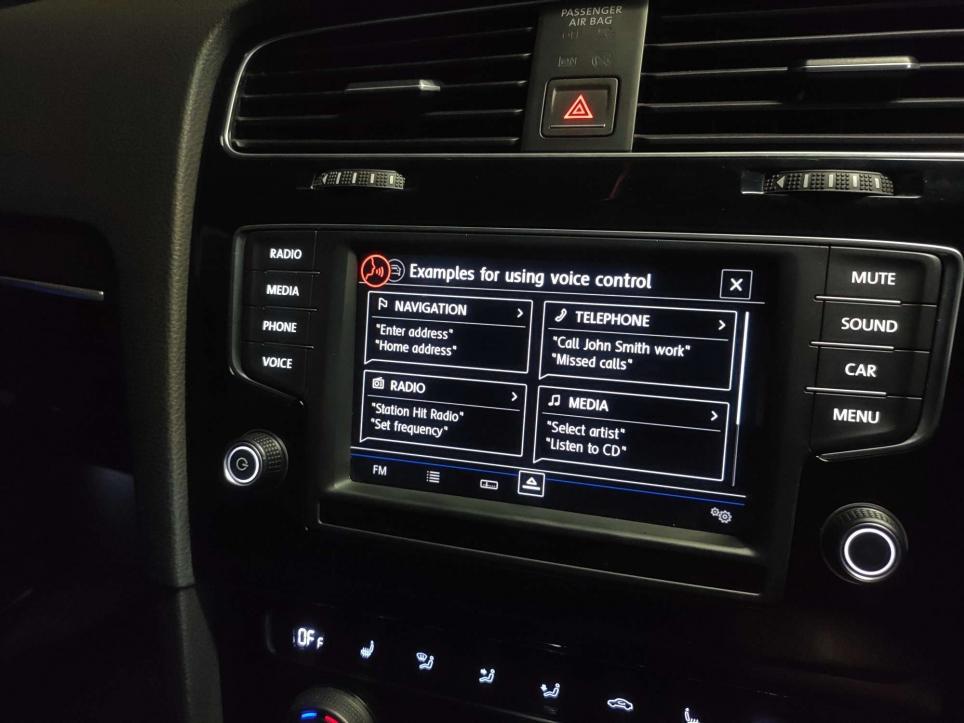

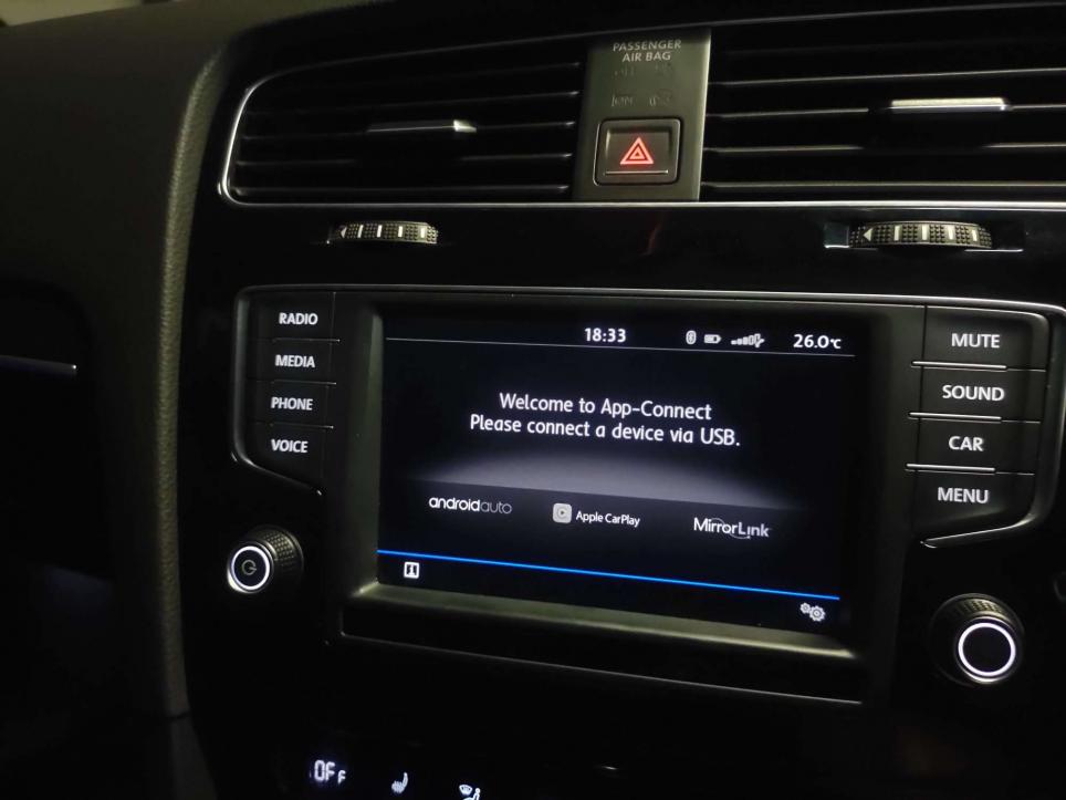

Anyway, did a retrofit on my Golf 7 R from MIB1 composition media to MIB2 Discover Media which included the 6.5" screen together with the infortainment unit (3Q0035876A - NAV unit) in the glovebox and the correct USB for app connect and carplay.

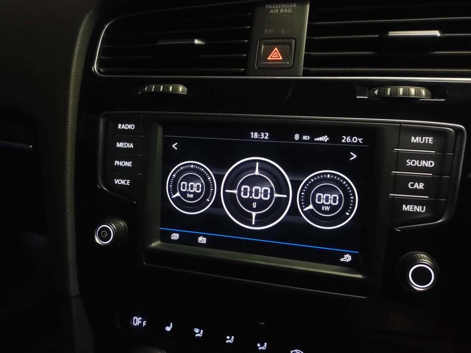

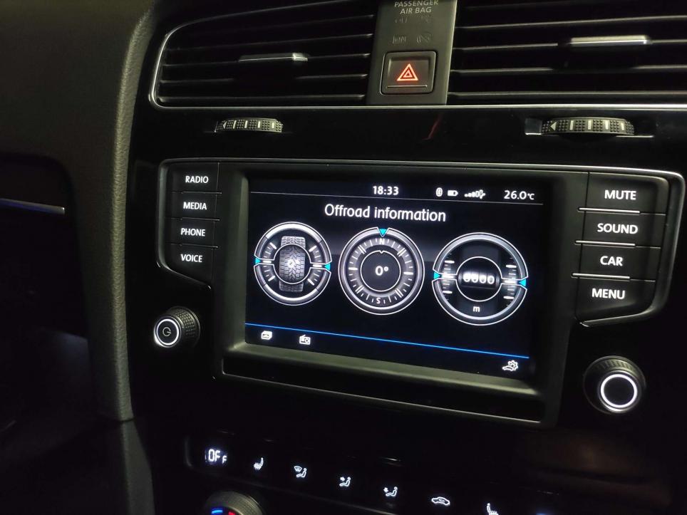

We managed to get everything working including flashing the unit from NAR (US) to EU firmware. Then unlocked app connect, performance meter, voice control, bluetooth etc.

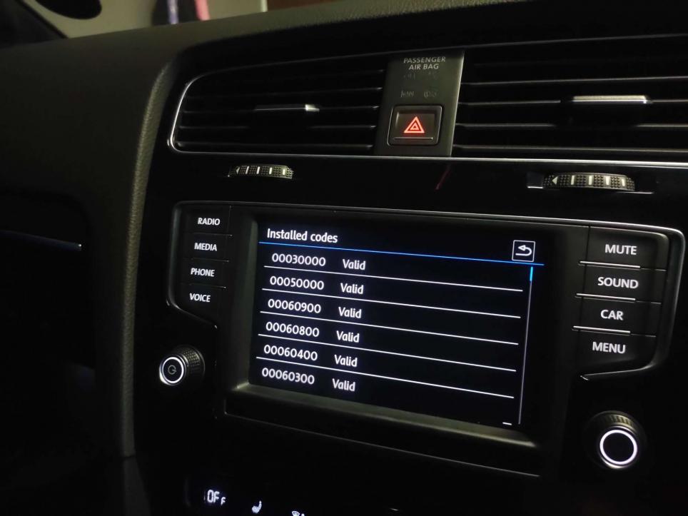

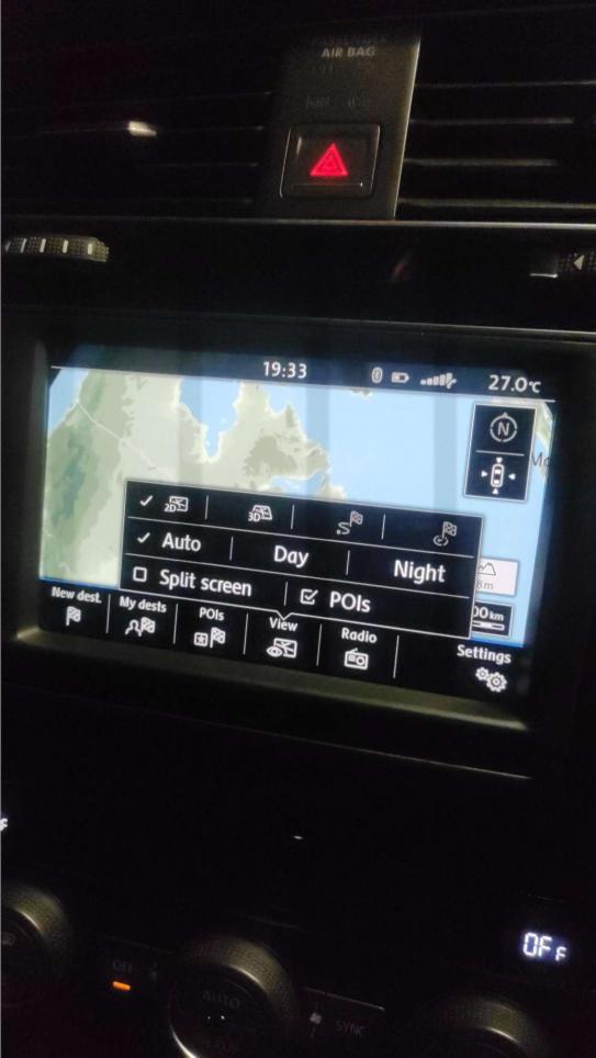

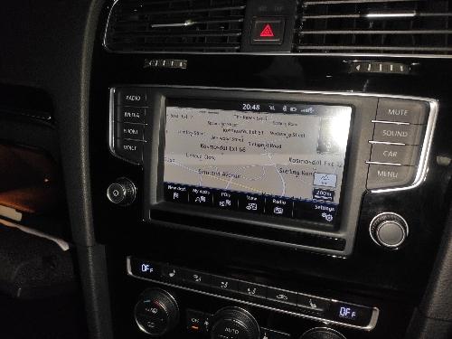

Only thing Im looking for now is the FEC/SWAP code for ROW navigation so that i can unlock the NAV function on the unit. (EU maps work as we managed to activate the EU FEC but it's pointless for my region)
Any one with discover media MIB2 system that can assist with the FEC code? (You can see installed FEC codes when holding the menu button for 5-10 seconds). I think developer mode needs to be enabled with VCDS though in controller 5F.
Anyone need any info or pictures of the setup, let me know. Will upload them here.
