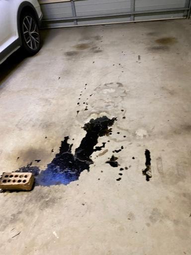

    So my wife's 2014 Golf Highline diesel left a bit of oil on the garage floor Thursday night and then on the way home from work yesterday the oil light came on (I had warned her to stop if it did). RACQ came and found total oil loss. Looks to be leaking from drivers side front of the engine but very hard to see where. Car was running perfectly prior to this and never a problem. It's done about 110k. Anyone else experience similar?

      This is not a gradual thing. It left a large over the garage floor (over one night) and heaps more at my wife's work carpark. Also left a big puddle of oil where she stopped waiting for the RACQ. Oil hadn't been checked in about a month but it has never used any significant amount of oil.
